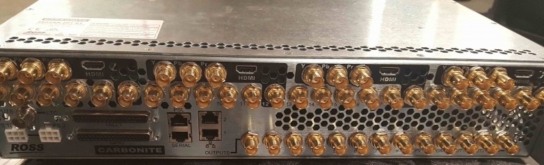

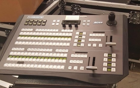

    We have Rossvideo Carbonite Frame with Carbonite Panel, we have faced the bewildered situation which we can not resolve at the moment. All at once the connection between the Frame and the Panel lost and we can resolve the problem. I have attached the pics of the equipment.
    The ethernet was connected on the PSL input of the frame and the Panel ethernet input of the panel, everything looks fine but the panel keeps booting and can't connect to the frame. What can be a problem for that ?

    That Panel does not have Ethernet on it.
    The connection RJ 45 is a Serial Connection that must connect to the FRAME PSL port directly.
    Did you check the PSUs for the Panel?  do you have redundant power on the panel or just the 1 supply?  could be that the PSU is not able to supply enough current during boot up if it is failing..
    did you try a different cable between them?
    Finally please call Tech support as that is Free and they can work with you in real time to trouble shoot things.
