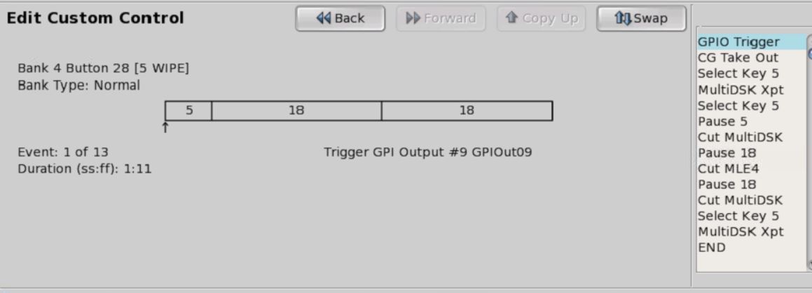

    This is how we built our wipe. We are using SS1 for the main GFX and SS3 for the alpha. Hope this helps if you have any questions please ask.
    #Vision
