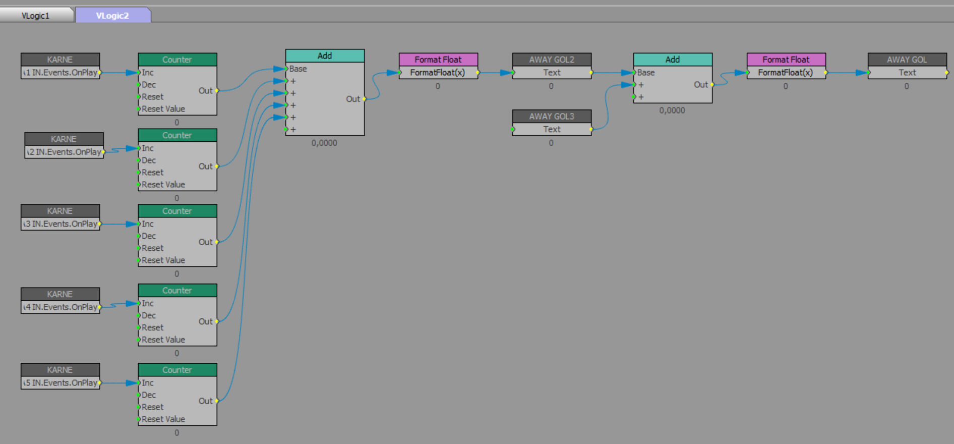

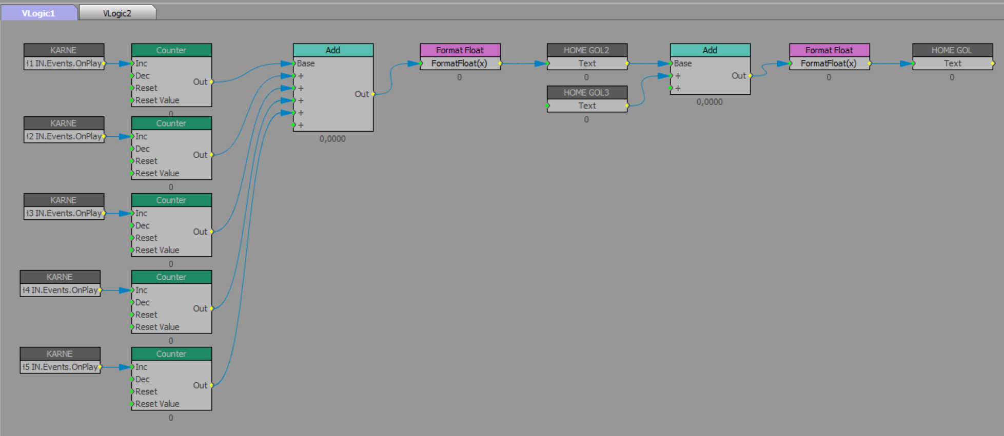

  • 1.  1. Automatic start of the additional time clock. 2. Adding a point to the widget counter triggered by the animation of a graphic element.
    Posted 06-08-2025 20:13
      |   view attached
    Hi, can I ask for some tips?
    (Problem 1 solved)
    (Problem 2  solved - details a little below)
    Counter scene:
    How can I trigger the addition of a point to the H POINT widget when the green square animation appears (I also want to maintain the possibility of standard widget control). The green square is also animated by the HG IN trigger scene.
    Thank you in advance and I am attaching the project.
    Example and solution:
    https://www.youtube.com/watch?v=CytyL1Ra5Us
    YouTube remove preview
    Uploaded by None on 2026-01-18.

    I found the method - update in the first post.
