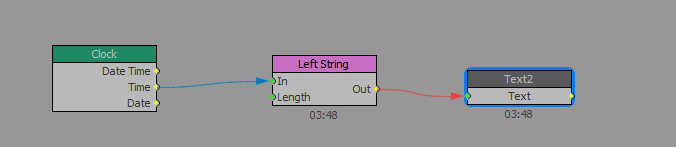

    I have gotten this to work through scripting. Unfortunately, it only works in Xpression Developer, and I need this to work in the Branding Player through BlueBox.
    I'm using a text object and grabbing local time via a clock widget.
    What is the best way to display a 12 hour clock WITHOUT the AM/PM in a bug?

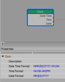

    Posted 01-10-2023 10:50
    A quick way is to use visual logic.
  • 3.  RE: 12 Hour Clock Bug
    Posted 01-10-2023 12:16
    That did the trick! Thanks!
