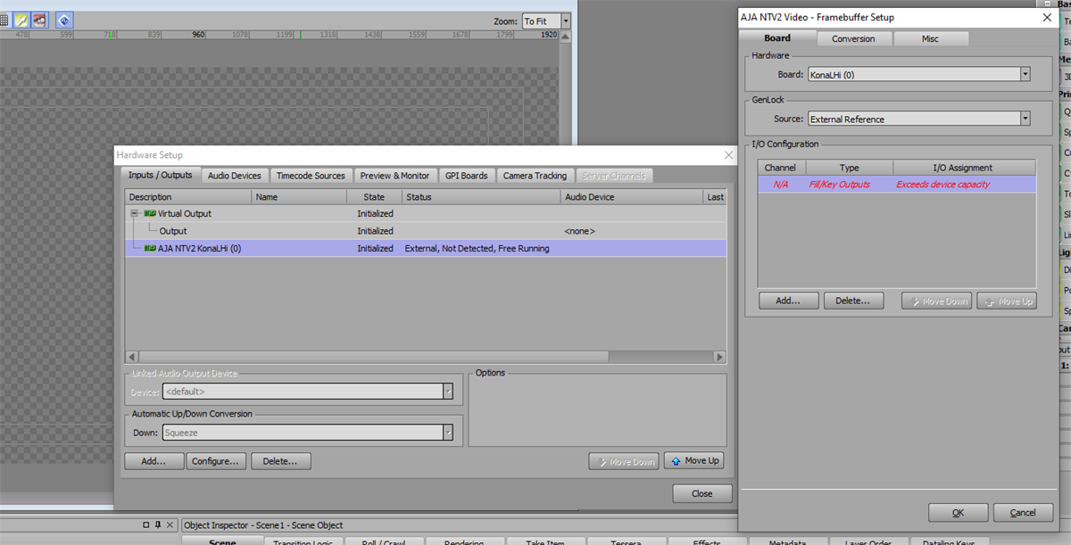

    Hello, trying to add AJA KonaLHI to Xpression 7.1, but as you can see on the image below, I can't able to add I/O configuration (Key/Fill Output), is there any trick or am I doing something wrong? I installed AJA driver 15.5 and then latest 17.5 but no luck.

    Supported NTV2 driver for XPression v7.1 would be 12.4.1 to 12.5.4.
    I do not know what the min driver version for the KonaLHI is.
