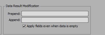

    Probably easier just to do that in XPression as you can prefix the data with a letter on the datalinq connection
  • 3.  RE: Adding prefix to incrementing number
    Posted 02-15-2023 07:50
    Ah that would be awesome if i was using Xpression 10, but unfortunately i am on Xpression 7, it doesn't have that append feature.

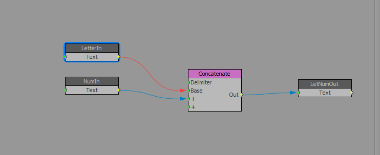

  • 6.  RE: Adding prefix to incrementing number
    Posted 02-16-2023 05:31
  • 7.  RE: Adding prefix to incrementing number
    Posted 02-17-2023 08:58

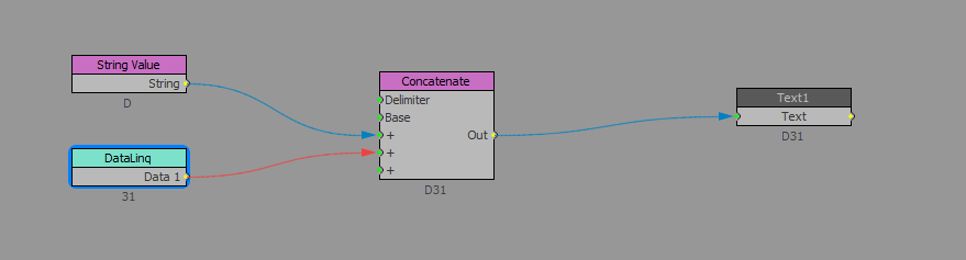

    Hi Simon,
    So I followed your diagram, but no luck.
    What do you think I am missing? I am using vers 7 so i think that is why i am not seeing the values under the function blocks, but i am not getting any change on my output text 1. Just the same number, 5 or whenever i change it, it remains with out the prefix. See images
    Cheers
    Brad
    Brad Howard

  • 10.  RE: Adding prefix to incrementing number
    Posted 02-20-2023 03:51
    Did you type the letter D into the string value or the description section of the VL block?
