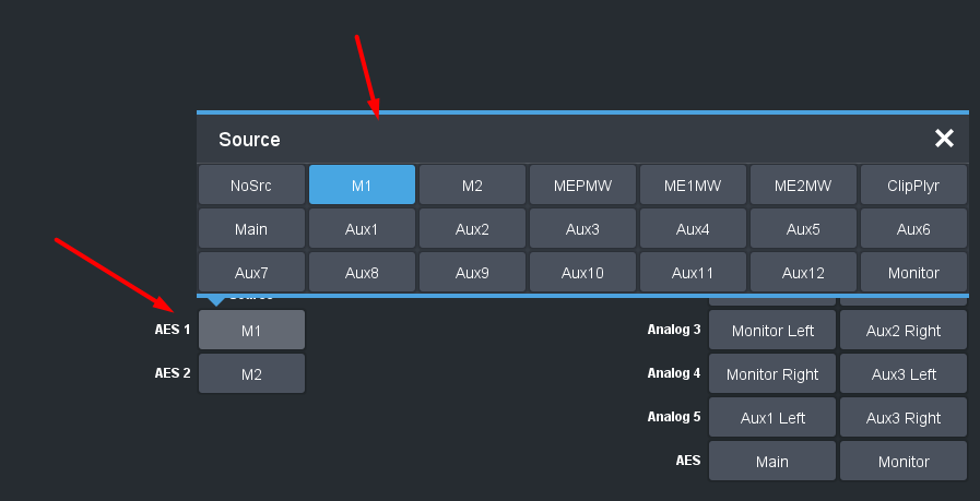

There is a "clip player" and there is a "Media Store". Can you please confirm which device you have it loaded in? And which Channel it is in?
If you have the Audio Mixer you could also look at the audio meters to see if it is present there in the audio meters if assigned to a channel.
For the AES outputs which source do you have them assigned to?
