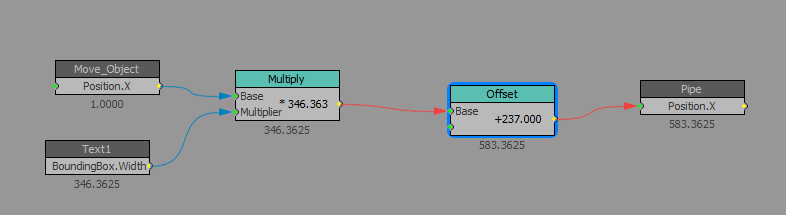

I couldn't resist so I had a play and the last method I suggest does work but dones't really have any advance over the solution you've ended up with.
Just going to put it here in case its of interest to anyone else.

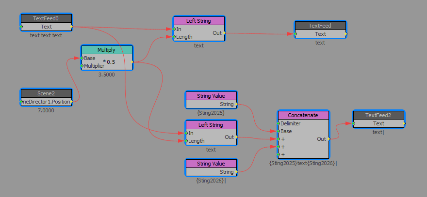

Ah yeah stagger animation would not work with this method, it would work with the visual logic string length and animation method though.

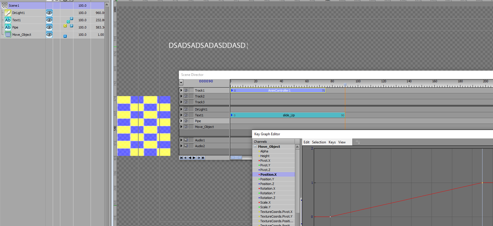

What you could potentially do is, animate an object from 0 to 1 on say Pos X and then take the total length from the boarding box and that would be your end value. Then you multiple the Pos X buy the total value and take that value to set the position of your flashing pipe. The duration of the animation 0 to 1 should match the length of you stagger animation and I think you'd be able to line them up.
I've never built exactly what I wrote above but I think it would work.

The other option I was going to say is if its a 1 line you could also to child object, like you would with a box that follows the size of the text and then tie the flashing text pipe to the right edge of the that box using bounding box connected to the pipes x position. That would work and would avoid having the second text object.

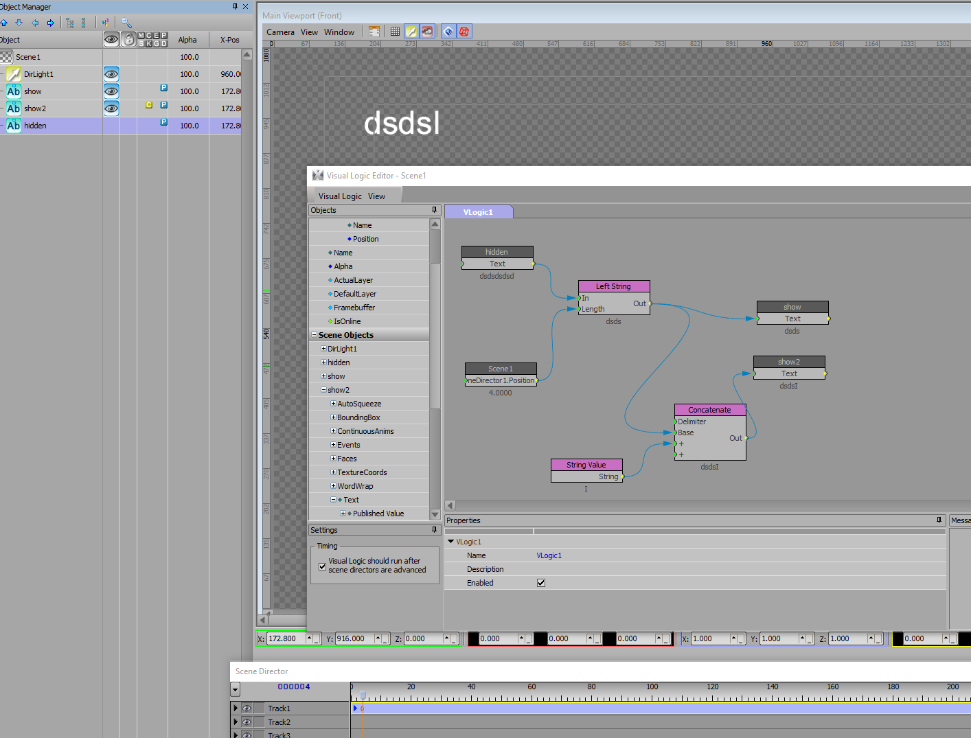

ok so its a bit janky, 3 text objects to do it.
1(show) is what you see, 1(show2) is same but with flashing line, 1(hidden) is what you publish and type to.

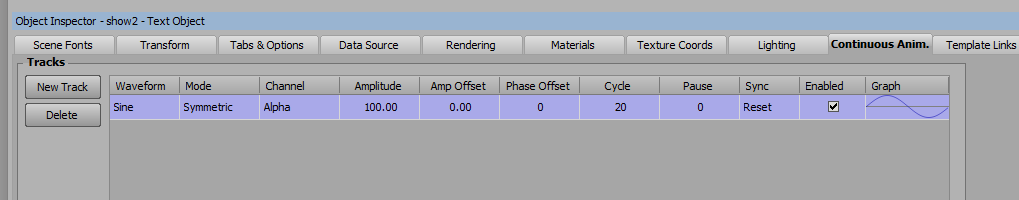

You animate you position and it will look line a type writer, the "show2" needs a continuous animation.

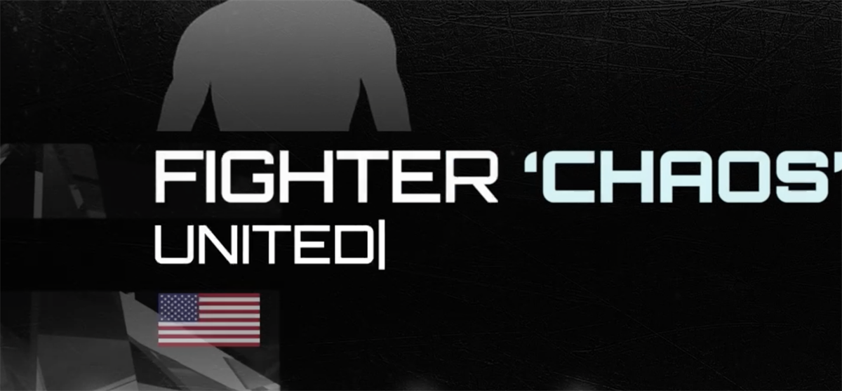

We have a graphic we need to replicate in XPression. You can see the example we are building to below. Early in the video, the "home country" of the athlete animates in. We have the stagger animation to bring that in letter by letter, that is no problem. - We are stuck on getting the cursor to grow with the text. So we would like the cursor to stay with the last letter that is on the screen and then come to a final resting place. - We have the final resting place done and good, and that updates based off the size of the bounding box, no problem. But we cannot think of a way to make the cursor animate across and stay pixel accurate to a distance from a character. (included a still from the video, as well as attached the video to this post)
