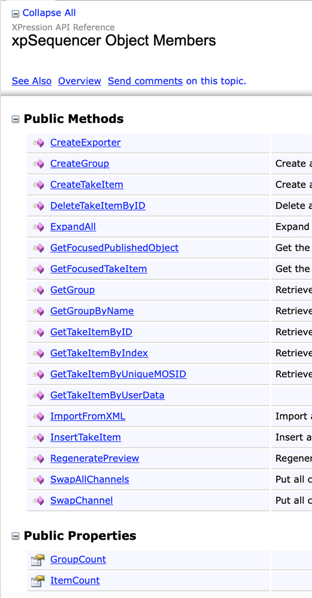

Ah, my bad. I see that MoveTakeItemByIndex was added in XPression 11.0. The other calls were added in 6.0.
All these calls were added in 11.0, I think these are what you are looking for:
- [implemented] xpSequencer.MoveTakeItemByIndex to move a TakeItem object to a index position in sequencer
- [implemented] xpSequencer.MoveTakeItem to move a takeitem either before or after a target takeitem in sequencer
- [implemented] xpSequencer.GetPrevItem to get the previous takeitem of a given takeitem
- [implemented] xpSequencer.GetNextItem to get the next takeitem of a given takeitem
- [implemented] can now get the sequencer index position of a takeitem using xpBaseTakeItem.Index and xpTakeItem.Index
Sent: 08-01-2023 22:55
From: Jack Reynolds
Subject: API Retrieve Sequencer TakeItem Index
My SDK does not list that, in both 9.5 and 10.5. I have the GetTakeItemByIndex, but what I really need is a GetFocusedTakeItemIndex, or a .Index property for either xpTakeItem or xpBaseTakeItem.
MoveTakeItemByIndex I do not have. Attempting to write this line in the IDE does not autofill any result. What am I missing?

In the SDK Help File:
xpSequencer.GetTakeItemByIndex
xpSequencer.MoveTakeItemByIndex(TakeItem, MoveToIndex)
