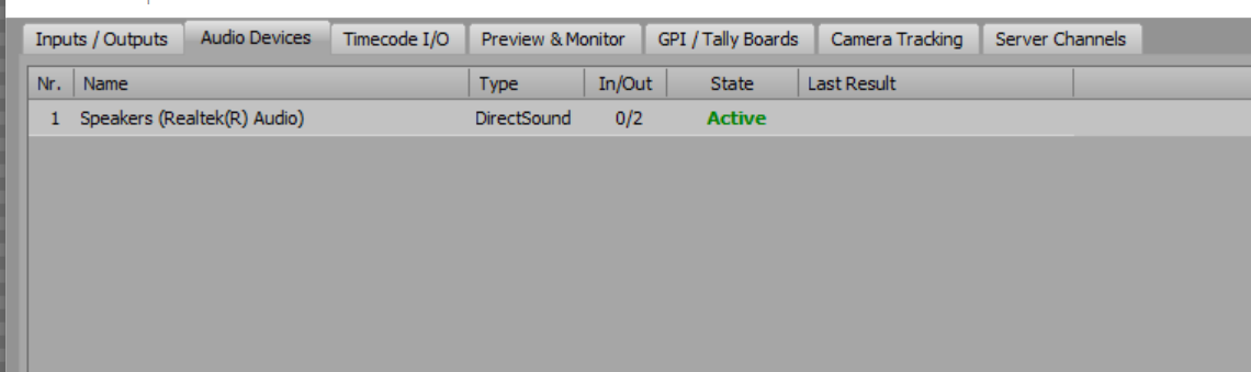

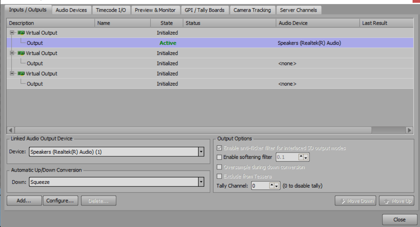

If you're designing on a desktop or laptop and using virtual outputs you'll want to set your audio devices so you can hear it.
