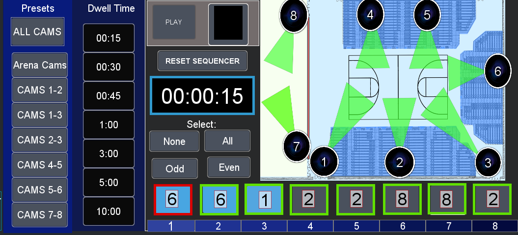

    I've been hard at work learning and building a large custom panel.  I've learned so much thanks to this forum and I really appreciate it.
    One of the tabs is an AUX auto-switcher that is like a step sequencer.  I was hoping I might get some help with this one.  I think I've gotten close but am not able to get it to work yet with the last hardest part, incrementing through the steps to send the Rosstalk commands when the timer hits 0, and then loop back to step 1 and continue until stopped..    There are 8 cameras.  Each of the 8 steps can select any of these 8 cameras.  when the step is toggled on, you can set the value to the label and also to an integer array by pressing the circle camera buttons.  I need to figure out the best way to make this happen.  When press play.. these values need to be set on the 8 ross talk commands for each step.  When the timer hits 0 need to increment through the array(or some other way) and loop. Sending the rosstalk command on each step.
    The panel is a bit of a mess at the moment, but I'll try to add some example of code I've tried. Any help would be much appreciated. Here is a screenshot of the panel.
    Thank You

    Hi Michael,
    Sorry for the delayed response. Would you be able to attach the code that you have tried? I look forward to finding a solution for you.
