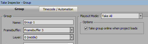

    If you are running XPression version 9.0+ you can use the Sequencer Group Playout Mode Take All, take group online when project loads feature.
    You would also need to enable the load recent project setting: Load Most Recent Project, in the Edit > Preferences > Editor > On Starup > Load Most Recent Project
    Put all the graphics you want for your default state in the group, when XPression opens and loads the projects it will take all the items in the group online.
