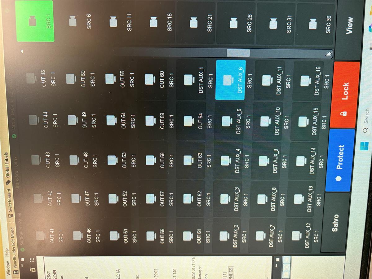

    Hi Aaron, yes I have created the soft panel and would like to do AUXs operation via touch drive panel as well. My procedures listed below:

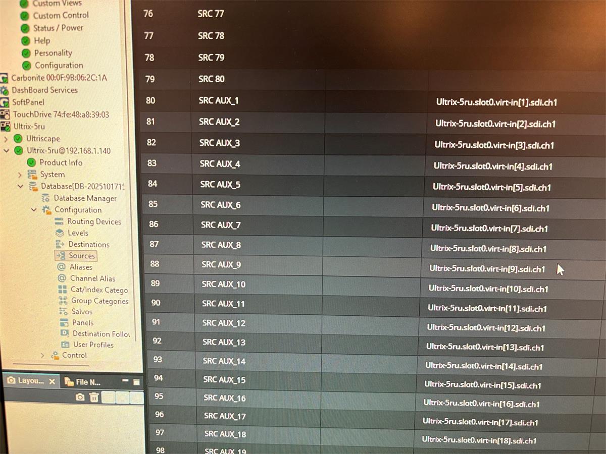

    1. create router aux source 1-28, fill in Ultrix-5ru.slot0.virt-in[1].sdi.ch1....virt-in[28].sdi.ch1

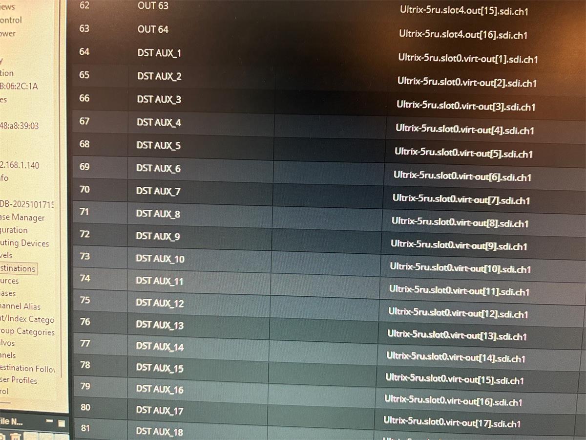

    2. create router aux destination 1-28, fill in Ultrix-5ru.slot0.virt-out[1].sdi.ch1....virt-out[28].sdi.ch1

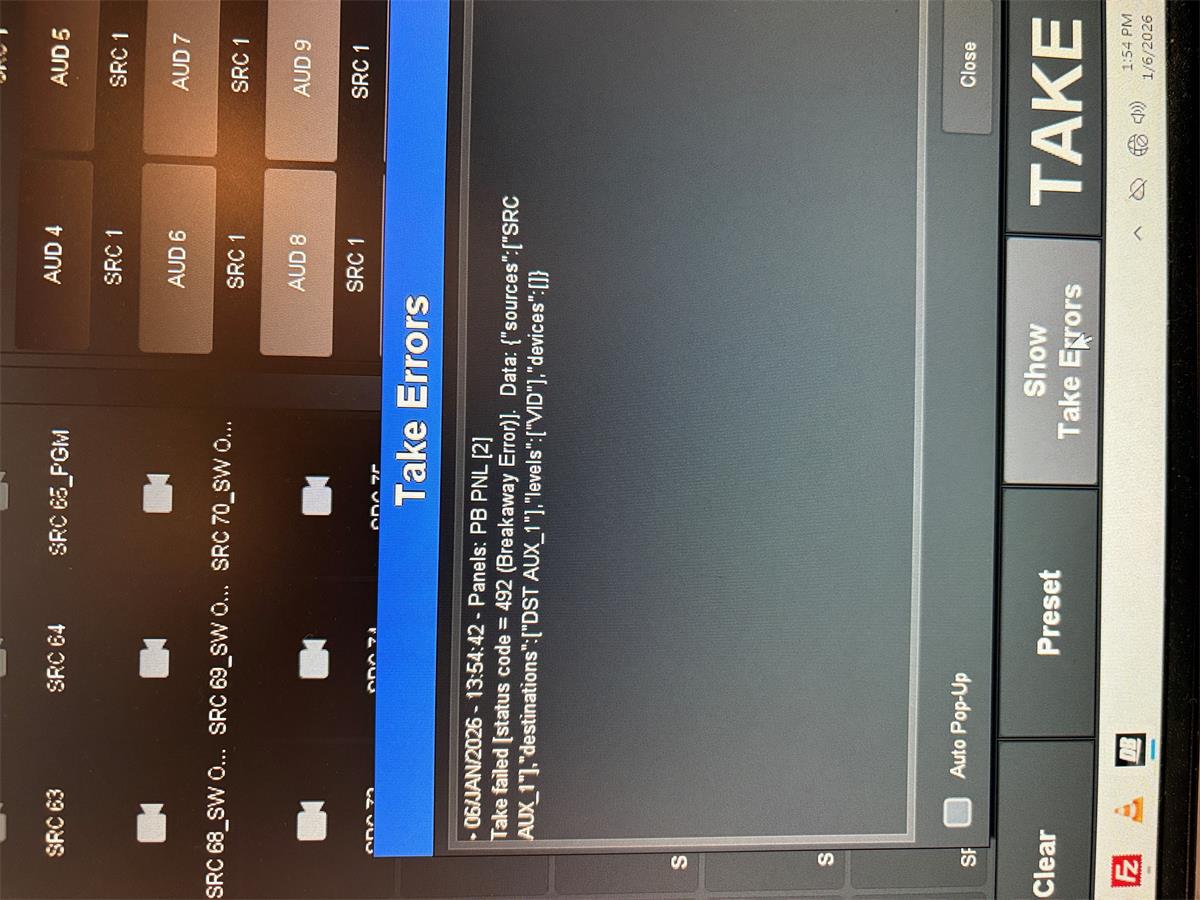

    4. route source aux 1 to destination aux 1, failed, error code 492

    Posted 01-08-2026 18:04
    I routed the aux 1 to physical Ultrix-5ru out, but it doesn't work. Whatever I select on aux bus via either touch drive panel or soft panel, the out is always stuck at input source 1.

    Hi Howard,
    When you say that routing aux 1 to physical Ultrix-5ru out doesn't work, do you get an error when you make the route? Could you share the error?
    Note that besides routing an aux to a physical output, you will also have to route sources into aux 1 in order for the output to display other sources besides source 1.
