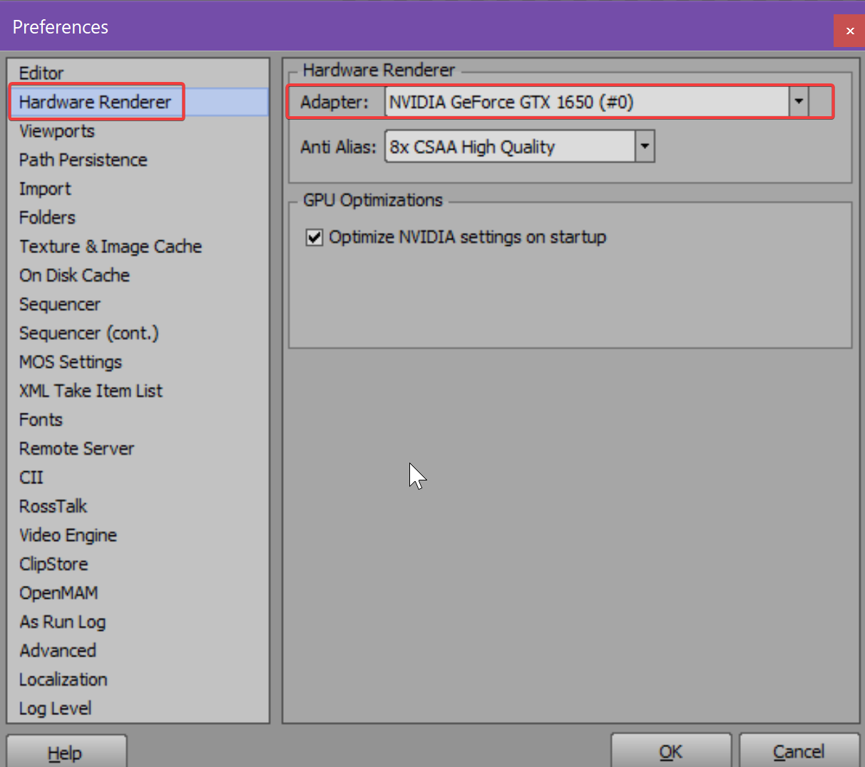

What type of output are you observing the banding on? (Virtual output, SDI, NDI, 2110, RossLinq)
What framebuffer are you using?
Do all your graphics show banding?
Do you see banding when outputting black?
If you are using a Matrox card, do you have GPU color space conversion enabled? Do you have enable full range output enabled? (Edit > Hardware Setup
Do you see the banding when outputting color bars? (Right click on output monitor and select Output Color bars)
Can you provide some screenshots of the issue?
Is the banding present when observing the output from different monitors?
