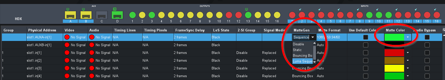

Hi Santi,
The Matte Gen option will override the source port, regardless of whether there is an input or not. The Matte Format drop-down allows the desired video format to be chosen; if set to Auto, it will match the incoming video format.

Hi Santi,
Ultrix doesn't have a bars & tone generator, but offers the ability to force any source to a matte source, it can be one of:
- Static color
- Static color with bouncing box overlay
- Luma ramp
This can be applied at any physical input port, and will override the input. So, best to use it on an unused input port on the Ultrix frame. This is configured in the Ultrix frame config menu.
