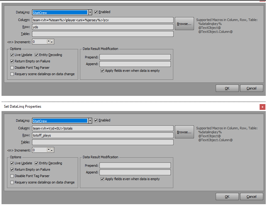

    I've not used XML filtering myself. But here are some examples of XML filters that work. I hope this is enough to get you started.
    team<player.uni=%jersey%>\player\rcv is trying to return the team based on the jersey number entered ("Return the team that has a player with jersey number X"). However, \player\ is always going to return the first listed player on either team. The query is "working", it just happens that player<1> for either team is defensive, so they don't have any receiving numbers that would be nested within \rcv.
    team<vh=%team%;player.uni=%jersey%>\player\rcv is doing the same thing; you're just additionally filtering by away/home ("Return the team that has a player with jersey number X, and has the vh designation of V/H").  In both cases the query is trying to return the first player listed on the team.
