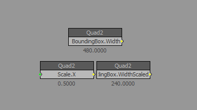

    Width scaled and width are different if you use something like autosqueeze.
    Above I had auto squeeze set to 400, the none scaled shows what it would be if it wasn't being squeezed, whilst scaled shows its squeezed value.
  • 3.  RE: Bounding Box Width vs Width Scaled
    Posted 12-29-2022 04:57
    In other word, WidthScaled is normal Width multiplied with the object Scale.X parameter.
