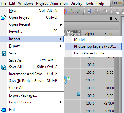

    Hello.
    Wondering if we are able to bring in PSD files into Xpression and see the layers unflattened. The same with C4D files.
    Any insight would be great.
    Sincerely,
    Michele Hampton
    Michele Lee Hampton
    Graphics Operator
    Hermosa Beach, CA
  • 2.  RE: C4D and PSD files into Xpression
    Posted 07-25-2022 14:43

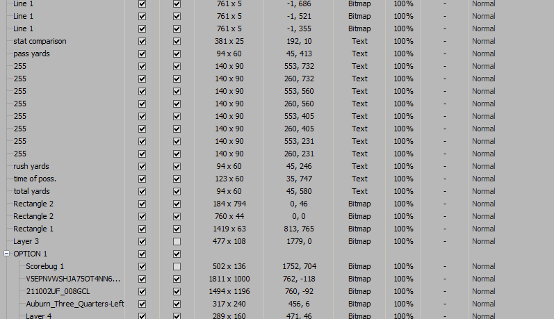

    You can bring PSD files into XPression like this;
    You'll see the layers like this and you can choose what you see;
    You'll also see a preview.
