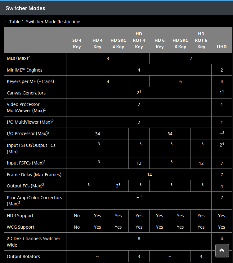

    we have a Carbonite Ultra 7.0.3 running in HD 4 Key mode and we would like to switch to HD ROT 4 Key to test the new feature (rotating outputs). I've looked into the switcher modes table and it seems to use the same number of resources. The only differences are in Input FSFCs and Output FCs.
    Do I risk breaking something when switching to the new mode? Is it as simple as doing a mouse click? Is there a chance of losing memories/CCs?

  • 2.  RE: Cahnging Switcher Mode for Carbonite Ultra
    Posted 08-31-2023 09:38
    Always recommended to save the switcher setup to a usb that is plugged into the frame.
    This change will have the system reboot and load a different FPGA configuraiton.  Your memories and Custom controls should not be affected.  You may have to do some work in configuration with regards to assigning FSFCs that are now "floating" vs fixed to every I/O..

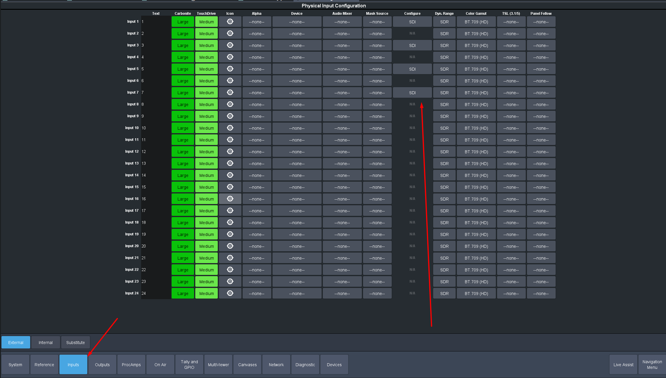

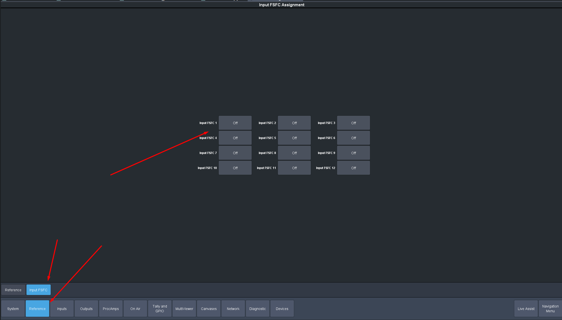

  • 5.  RE: Cahnging Switcher Mode for Carbonite Ultra
    Posted 09-11-2023 14:49
    When you are in a mode that does not have enough conversion for every I/O (or your not licensed for all...) then you have to use the Reference menu to first Assign them to the I/O where you would like them..
    Covered in the manual Here:
    https://help.rossvideo.com/ultra/Tasks/Setup/Video/IO-Proc/IOProc.html?hl=reference%2Cmenu
    Once you assign them to inputs..
    now you will be able to enable and configure them:
