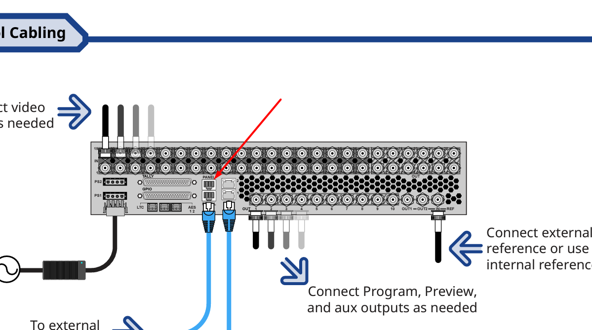

Carbonite Black Frames Have the Panel serial port to allow the older grey panels to directly connect to them.
Ultra Frames do not have that port ..
There is the CarboNET device that would allow the panel to connect to it and then turns it into Ethernet control so that you can control any carbonite frame type over the network.
