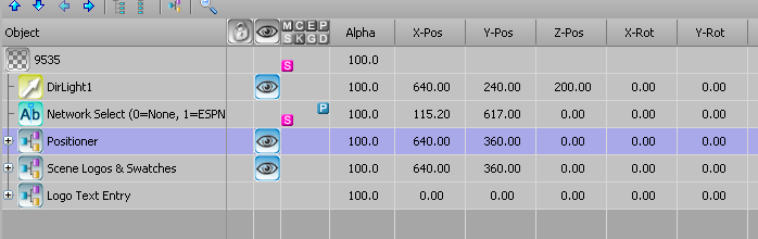

The screenshots are all in my original message, but I want to write Y-Pos = 320 into the positioner object in my scene 9535. The screenshot of the scene objects is above.

I am trying to write the following keyboard script that changes the position of a scene. I can successfully locate the scene and get the XYZ positions from it, but I cannot set the values. Interestingly, when I test the script, it returns that the value has been updated, but the preview window or the values in the editor do not reflect that.
Both the .PosY and the .SetPosXYZ do nothing apparently. The commented is what I hope to achieve, toggling between the two values for the scene.
dim positioner as xpBaseObjectdim hold as xpScenedim xInit, yInit, zInit as doubleengine.GetSceneByID(9535,hold)hold.GetObjectByName("Positioner",positioner)positioner.SetPosXYZ(640.0, 320.0, 0.0)positioner.PosY = 320.0'if yInit = 360 then'positioner.SetPosXYZ(640.0,320.0,0.0)'else if yInit = 320 then'positioner.SetPosXYZ(640.0,360.0,0.0)'else'positioner.SetPosXYZ(640.0,360.0,0.0)'end if
