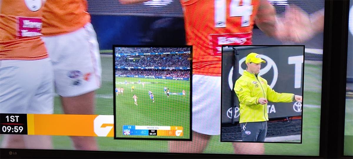

    Hi, strange one.... did this ever get resolved and what was the issue?

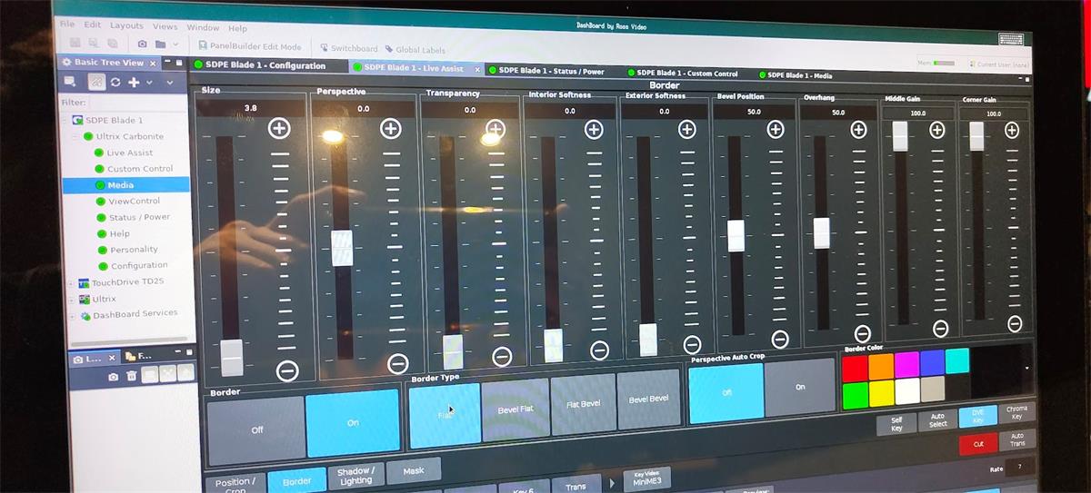

    I have a Carbonite Ultrix on version 9.1.10 and we are seeing this. I havent seen it before and i know we have made borders before that have been razor sharp! :)
    Just not sure why now we are having this issue. Also none of the Border Type buttons seem to have any affect on the output and look of the border???
    we are in 1080i/50 mode.
    Left PIP is the one that carbonite is making witht he settings shown. The PIP on the right is part of the media still graphic to show what we want.

    Can you explain what you mean by no effect?  I just configured and set this up and the controls do what they are labeled.  Yes the edge has some softness even when softness is set to 0 while older Carbonite Black and Graphite units have straight edges.  Something in the Advanced Borders is not allowing 0 to be 0.
    However if I move the inner softness or outer softness those controls work.. changing the Flat and Bevel settings work as does over hang.

    Hi Les, after making the border thick to the point of comically thick, we could engage the 'bevel' effect and could see the results, so it was doing something, its just at thin settings, you cant see the results. it also needs to be on anything but black for color from our tests. if the color is black, then we couldnt see any changes when adding 'bevel'.
    Tech support can see the issue I'm reporting, being 'fuzzy lines when trying to make razer sharp thin borders'.
    Ticket 217217.
