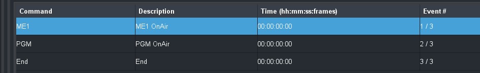

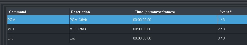

    Made a couple CCs to enable and disable tallys and even though the CC's record correctly, they don't execute at all when run.

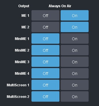

    Wonder if part of the issue is that the cc records it as PGM and the On Air menu shows it as ME1 and ME2.
    In any case, neither ME toggles under CC control. They work correctly when manually toggled in Dashboard.
    Additional note: It doesn't matter if I record it with Dashboard clicks or from the control panel. Same result.
