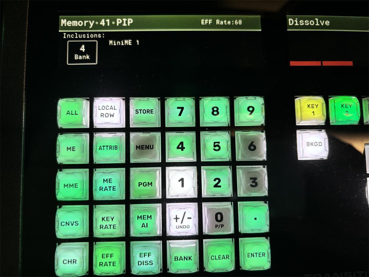

Looks like you have Step 1 and 2 reversed ..
With STORE not lit up you are on the "recall side" of the Memory system an you are setting the EFF Dissolve Override Rate.. That should stay as MEM all the time for you..
Press Store to first move to the "store side" of the memory system ... Now setup your Eff Rate and Eff Dissolve mode.
It seems like somewhere in your steps your setting up the Recall side to not be in MEM mode.

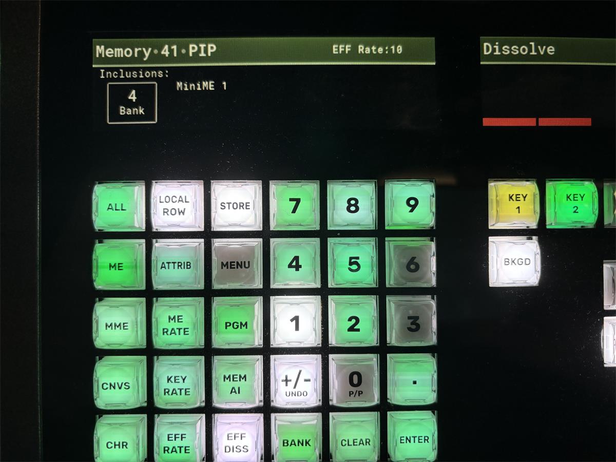

Thanks Les. I am following your process and I understand (I think!) all the associated buttons. Let me show you where this goes off the rails immediately for me. This mirrors your steps 1 and 2.
- Image 1 shows that I have set an Effects Rate of 60 frames (EFF RATE - 60 - Enter)
- Image 2 shows that after I press Store, the rate changes, in this case to 10 and turns on EFF DISS. All I have done here is press the Store button.
All button presses are on the Memory Panel, not Attributes.
Here are my steps (all in Local Row)
- Set up Effect 1
- Press EFF RATE - 10 - Enter. (EFF Rate 10 displayed)
- STORE- (EFF DISS turns on) MEM1 - Enter. EFF Rate display shows 10 frames as expected.
- Set up Effect 2 (which has carried over the 10 frame rate)
- Press EFF RATE - 20 - Enter (EFF Rate 20 displayed)
- STORE- (EFF DISS turns on. EFF Rate displays 0) Mem2 - Enter. EFF Rate displays 20
Mem1 now also has a Eff Rate of 20 displayed in the Memory Panel. Not the 10 frame as stored.
PGM - Mem AI - EFF DISS are off
In Attributes - Recall - General, Effects Duration From Memory is on (brown)
Where am I going wrong.
