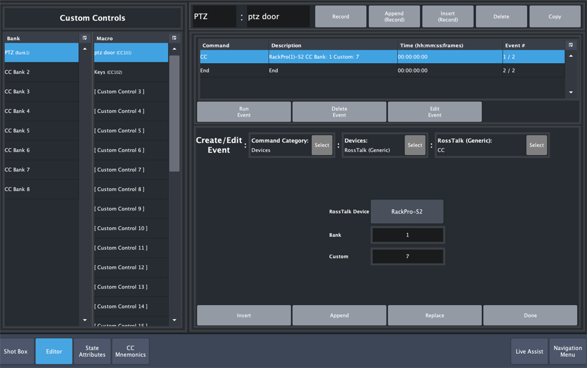

Skaarhoj RackPro 2 can it get triggered by Touch drive D2?
The outcome I desire is that when I push a button on the Ross video control panel, it operates with the blue pill. What I do not understand is the bank number on the RackPro.

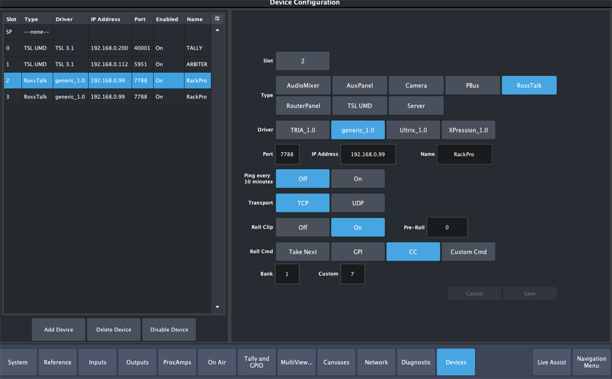

Here's what I have done:
Ross Video Dashboard > Configuration > Add Device
Slot 2
Type: Rosstalk
Driver: generic_1.0
Port: 7788

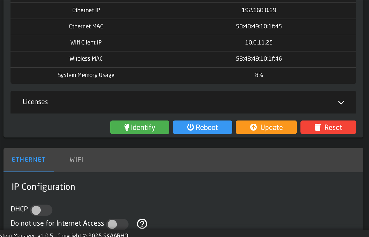

IP Address: 192.168.0.99 (RackPro)
Ping every 10 min: OFF
Transport: TCP
Roll Clip: On
Roll Cmd: CC
Bank: 1 Custom: 7

Ross Video Dashboard > Custom Control
Create/edit events: Devices
Command Cat: Rosstalk (generic)
Devices: CC
RossTalk Device: RackPro
Bank: 1
Custom: 7
What buttons are the Bank and Custom in RackPro 2?
