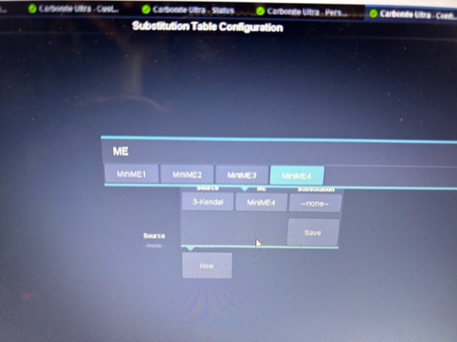

    Aaron thanks for your quick response.  Not sure why but my Ultra Carbonite only gives an option for MINI ME 1-4 in the sub table.  Here's some screen shots.  Is there a way to swap inputs using the MiniMe's since it appears I dont have the option of a ME in the SWAP page.  Thank you!!

    Hi Steve,
    You do not see ME Substitution because your Carbonite Ultra is on v6.6.1 firmware. ME Substitution was added in v7.0.0, and the latest version is v7.1.6. Besides substitution, other useful features like UltraScene were added in v7.0.0, making the upgrade worthwhile. I have attached the release notes.
    v7.1.6 firmware can be downloaded and installed at no cost. (https://www.rossvideo.com/support/software-downloads/carbonite-ultra)
    The upgrade process is easy and straight forward.
