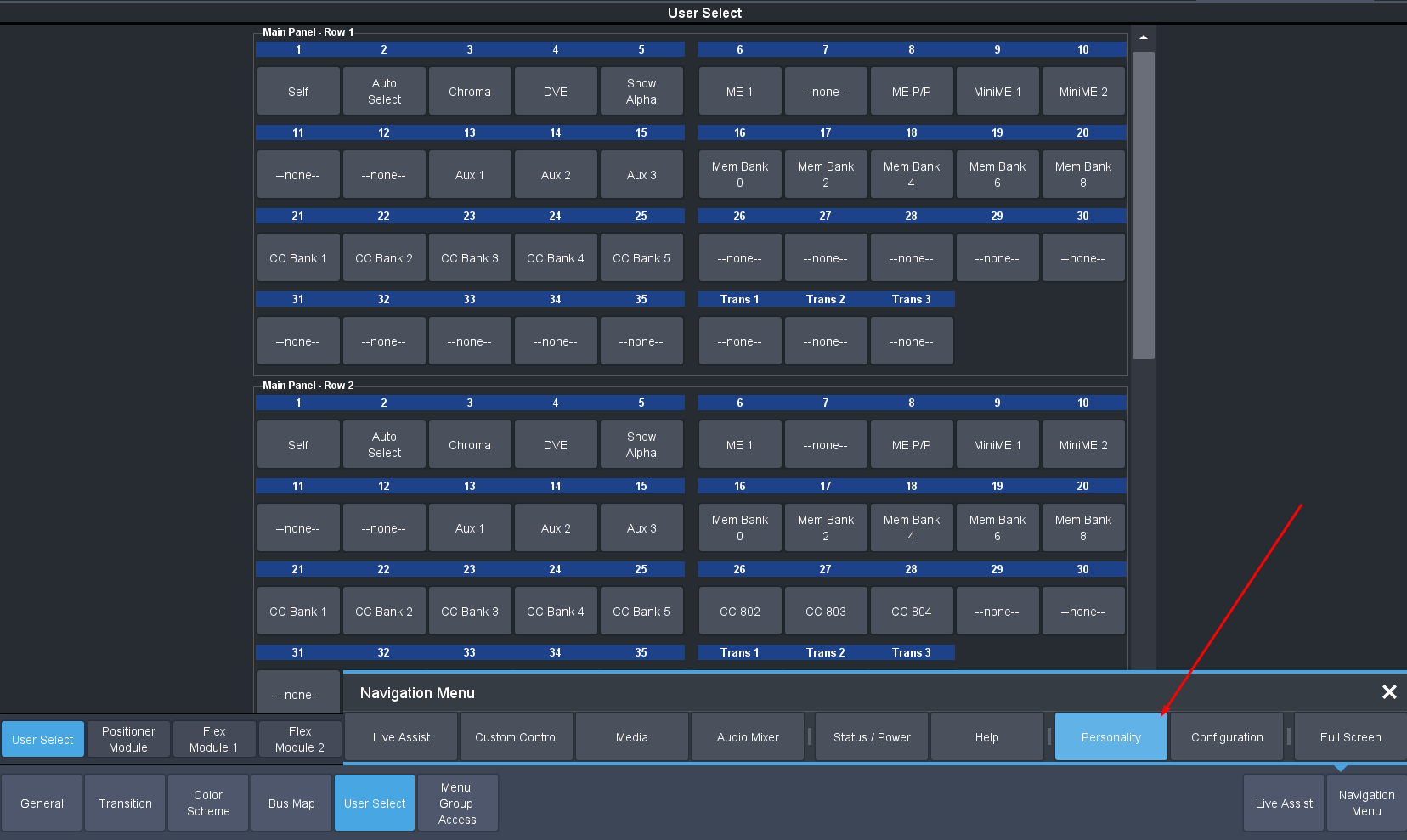

    When you connect from the DashBoard which port are you using?  if the panel is connected as the Main Panel then DashBoard to control it's personality will need to be talking to Port 5253.
    Then under personality you will find the user buttons configuration menu
