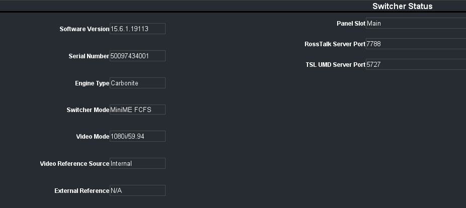

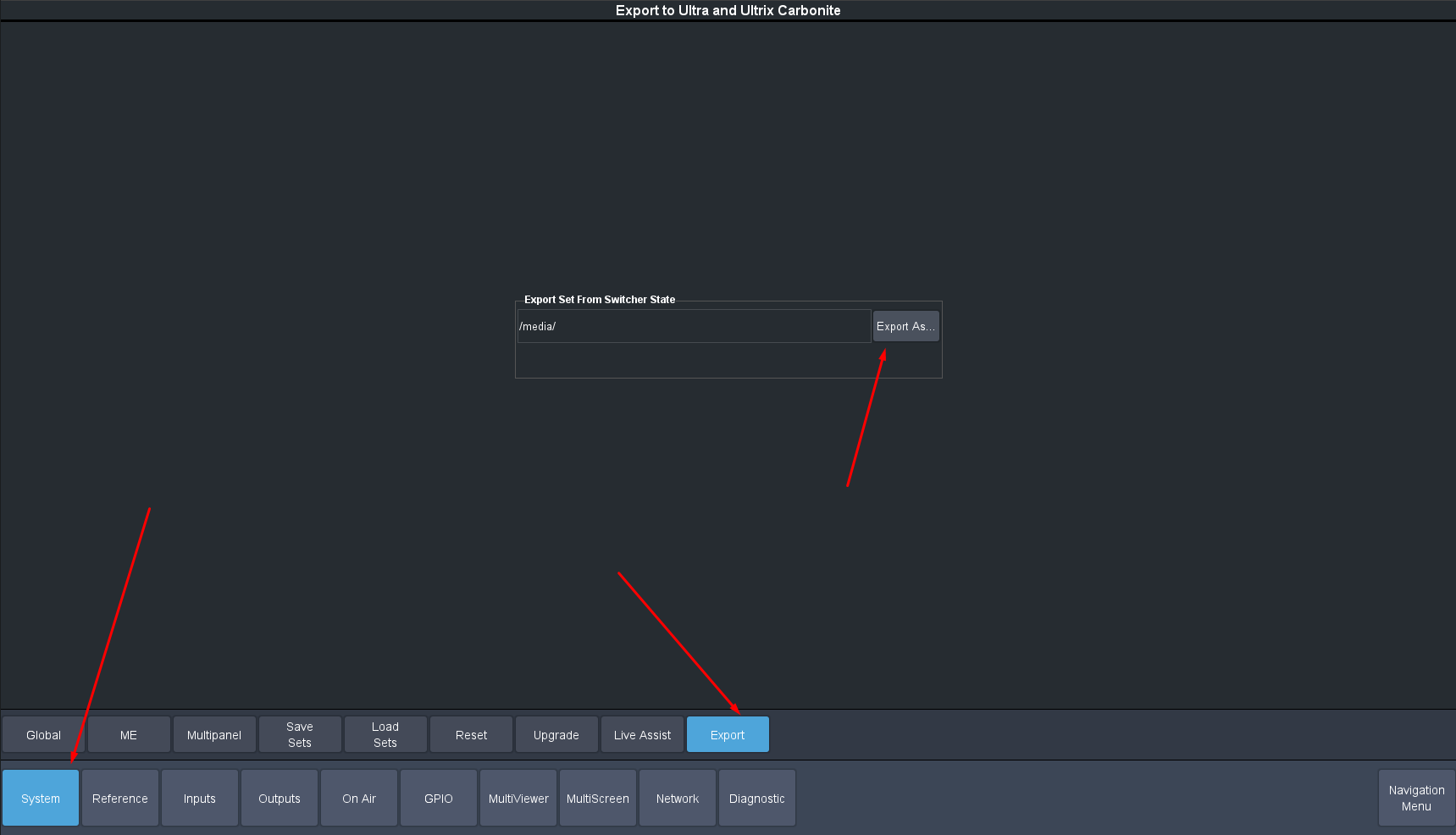

    At least on 15.6.1 with your Carbonite as above..
    Export to the PC running DashBoard ..

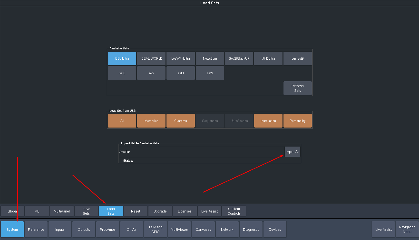

    Now go into the Ultra60 (I am using Ultra as example) .. and Import the files.
    Then Load it up :)
