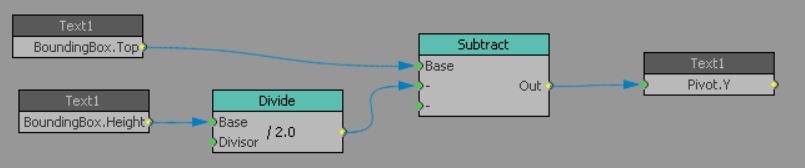

    Roma's example scene does not work optimally with different font sizes. But if you do not change the y position of Text1 in the VL and set it to 0 and use it's Pivot.Y point as center with this kind of Visual Logic, then it should work with any size fonts:
    I will attach a modified xpf-file.
