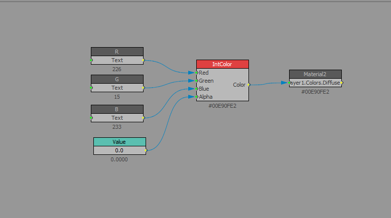

    You can achieve it via Visual Logic if that works for you.

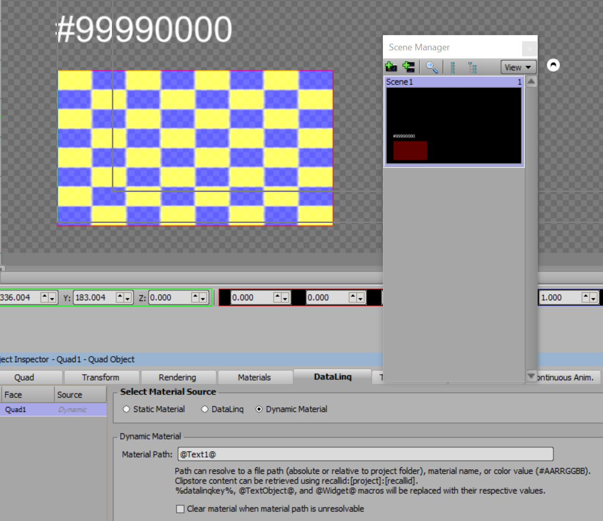

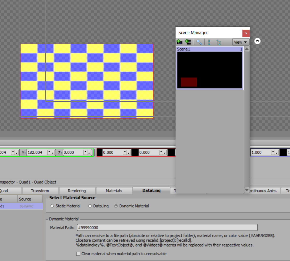

    You can also use dynamic materials and marcos.
    For example this is red typed directly into dynamic material  #AARRGGBB
    And then this is doing the same but using a text macro which could then be published.
