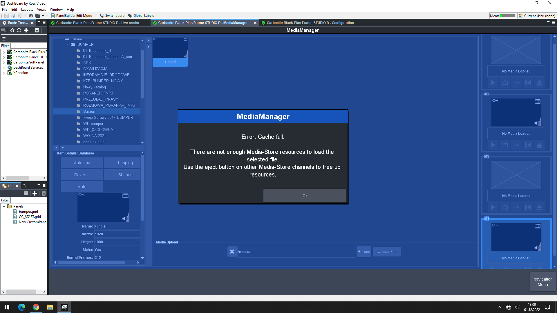

I unloaded (ejected) all 4 channels
Dec 1 12:59:03 amazon user.notice amazon: C: 678 S: NOTICE T: ConnectionRunStub p:2080380032 "YAMP Dashboard 0, Media1 Clear , PANEL_MS_ACTION_YAMP_MSG_TYPE" at panelmanager.cpp:4242.Dec 1 12:59:04 amazon user.notice amazon: C: 679 S: NOTICE T: ConnectionRunStub p:2080380032 "YAMP Dashboard 0, Media3 Clear , PANEL_MS_ACTION_YAMP_MSG_TYPE" at panelmanager.cpp:4242.Dec 1 12:59:06 amazon user.notice amazon: C: 680 S: NOTICE T: ConnectionRunStub p:2080380032 "YAMP Dashboard 0, MS_LOAD_YAMP_MSG_TYPE" at panelmanager.cpp:4242.Dec 1 12:59:08 amazon user.notice amazon: C: 681 S: NOTICE T: ConnectionRunStub p:2080380032 "YAMP Dashboard 0, MS_LOAD_YAMP_MSG_TYPE" at panelmanager.cpp:4242.Dec 1 12:59:09 amazon user.notice amazon: C: 682 S: NOTICE T: ConnectionRunStub p:2080380032 "YAMP Dashboard 0, Media2 Clear , PANEL_MS_ACTION_YAMP_MSG_TYPE" at panelmanager.cpp:4242.Dec 1 12:59:11 amazon user.notice amazon: C: 683 S: NOTICE T: ConnectionRunStub p:2080380032 "YAMP Dashboard 0, Media4 Clear , PANEL_MS_ACTION_YAMP_MSG_TYPE" at panelmanager.cpp:4242.Dec 1 12:59:26 amazon user.notice amazon: C: 684 S: NOTICE T: ConnectionRunStub p:2080380032 "YAMP Dashboard 0, MS_LOAD_YAMP_MSG_TYPE" at panelmanager.cpp:4242.Dec 1 12:59:26 amazon user.err amazon: C: 685 S: ERROR T: MSCacheModification p:1620046976 "Failed to allocate a frame" at cachemanager.cpp:1419.Dec 1 12:59:26 amazon user.err amazon: C: 686 S: ERROR T: MSCacheModification p:1620046976 "Failed to allocate frames" at cachemanager.cpp:1432.and put animation on the M2 channel and it returns error: cache full. The only way to fix it is hardreset.
I understand the solution is eject this specific animation which was loaded earlier and now is protect, but i don't know which one is it.
for example:
on first show was loaded 50frames animation
on second: show 5 different stills,
on third: 150frames animation and 10 stills
next show -captured 12 stills,
next show
next show (everything is working fine)
next
next
and bam!
error despite fact that the last thing was loaded to media channel was 1 frame still.

It is not included in the Black Software..
Again I am not understanding why there is a need to "clear the cache"? The Cache Auto Manages.. The only thing that will prevent loading is if there is not enough space due to an Item that is too large is currently loaded in a channel.
The only items that will not "auto remove" , when space is required to load a requested item, are the items that are currently on a channel. When something is in a channel it is protected. You first Eject it from the channel and that will remove it from being protected by the cache system.

Same problem
Carbonite Black Plus model 4804AR-202-01 software 15.5.2.18897, Dashboard 9.2.2

From: Les O'Reilly
Subject: Clear mediastore cache
There really is no need to "clear the Cache" as the system automatically will dump Stills and animations as new items are requested. This is done from Oldest used. As you recall something it automatically goes to the top of the priority stack.
The only other thing that would block you is if you have something in a channel that has large number of frames that the next item you are looking to bring in has more frames then what it can allocate excluding that loaded item. In that case you need to eject the channel which will tell the system that it is available to be removed..
In some of the newer systems there is now a media cache manager in dashboard that you can view this and also manually eject items.
If you could please attach a screen shot of the Dashboard status page for the Carbonite. This will help us understand which version of software and which engine type to have to give you some further suggestions.
