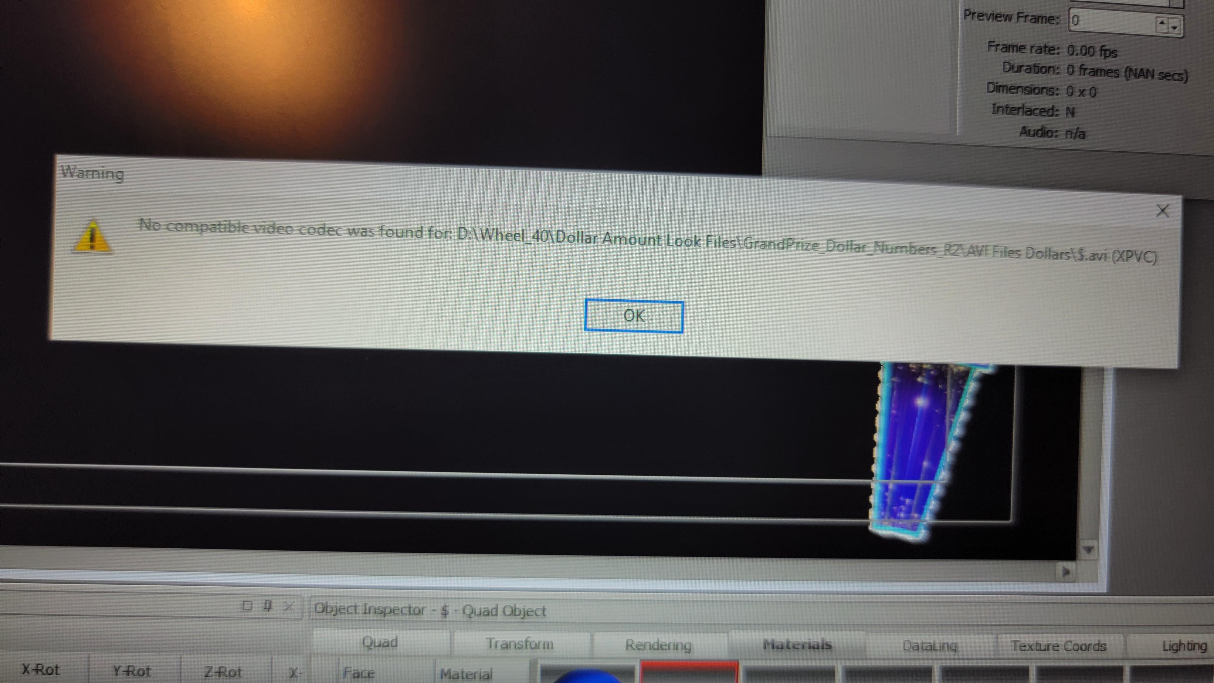

    I built AVIs in my in studio show Xpression. I want to be able to work on these AVI files on my laptop, but it is telling me that there is "No compatible video codec was found"
    I am on v10.5 build 5477 beta (64 bit)
    Any insight would be great.
    Attached image.
    Laptop screen grab

    What codec was that avi made with?

  • 4.  RE: Compatible Video Codec
    Posted 08-03-2022 12:54
    Ok thanks Garrett. Are you saying in the rendering out to the AVI that I should rename it to say "dollar" not "$"?

  • 5.  RE: Compatible Video Codec
    Posted 08-03-2022 13:08
    I do not know that that will fix your issue, but I do know that computers get confused sometimes by that stuff.  Like having a . inside of a file name can throw things off.
    Seeing your reply to red.  Just checking that you used a PC to convert into the Xpression codec and not a Mac?  Because to my knowledge they still do not make the Xpression coded of OS X.

  • 6.  RE: Compatible Video Codec
    Posted 08-03-2022 13:20
    Hi Garrett.
    Yes I coverted the TGA files in After Effects on a PC but used the Xpression Video Coder on the render out from After Effects. I tried the Video Coder program from Ross Xpression but it did not work properly on the TGA files I received. I got the files from a graphic house. I did not build them.

  • 8.  RE: Compatible Video Codec
    Posted 08-03-2022 14:41
    Hi Garrett.
    So the AVI files play out fine on my Xpression I am on in the studio, but when I try to get them to work on my laptop it says that there is a codec issue. So there is what the confusion is. And the warning on the attachment I have here is what my personal laptop is saying when I try to get to the AVI files. Works fine on my Xpression in the studio.

  • 9.  RE: Compatible Video Codec
    Posted 08-03-2022 15:14
    Long shot. when you installed Xpression on the laptop, did you do a full install of the software?  I know there are times where you might only move the application over and so some items do not follow.  Typically in the past, I have just done a full reinstall of Xpression and that lets me know that everything installed where it was supposed to.

  • 10.  RE: Compatible Video Codec
    Posted 08-03-2022 12:52
    Hi Red.
    The codec was Xpression video coder 2 - 10.5 in After Effects

  • 11.  RE: Compatible Video Codec
    Posted 08-04-2022 04:38
    What version of XPression is on your laptop?
    I am tempted to suggest you render to the older XPression codec and try that, I can give you an installer if you want to try.
  • 12.  RE: Compatible Video Codec
    Posted 08-05-2022 13:10
    Hi Red.
    Sorry for the delay. I am on v10.5 build 5477 beta (64bit) on my laptop.
    I was thinking the same thing about just re rendering the tga files that were sent from the graphic house out from my laptop in AE.
    I don't think there will be any generation loss.
    I need these for pre production for our editors. I build the dollar amounts then send them for their reels to bring to the studio on show days. If i can't get it done on my laptop then that is not really great. Would take up time in the morning on show days.
    What do you think?
    I have the installer on my laptop. The video coder is version 10.5 beta. Does that make sense?

  • 13.  RE: Compatible Video Codec
    Posted 08-05-2022 15:04
    So I just re did all the files in AE on my laptop. I think they look fine and they work on my Xpression laptop program.
