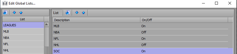

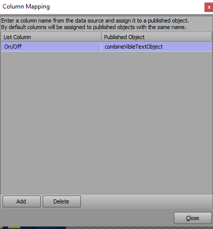

No worries, it might be what you want. Add a new column to your global list with something like 1/0 or On/Off next to the paths.
The make a text object to control the vis of the fields that checks that text box.
Then use assign colomns.
Then when that line is selected it will forward the contents of that column to the text object.

I don't, I was playing around with it earlier but with no luck lol

Do you know how to use assign columns?
