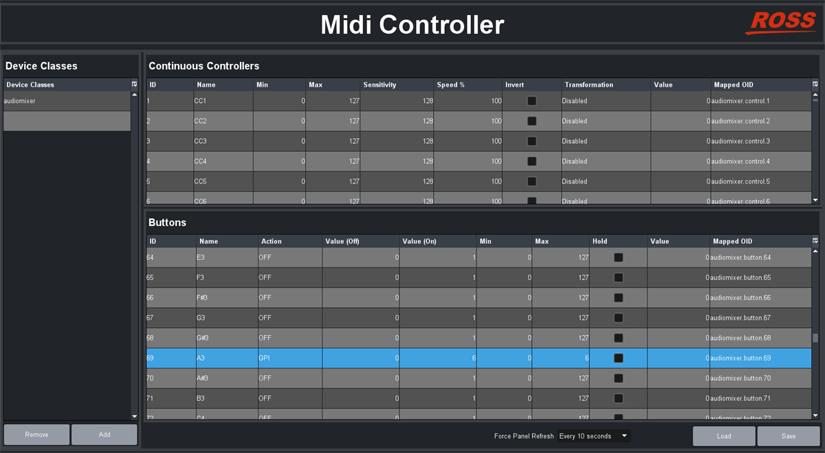

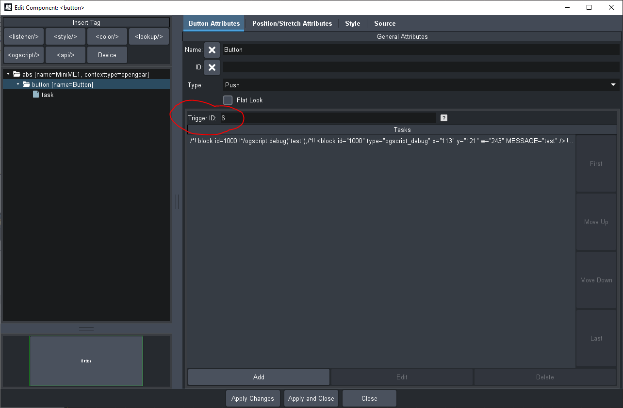

If you have a button in your panel with a "Trigger ID" of "6", the example you posted should cause it to be triggered when button number 69 is pressed.
If you want to see if your GPI trigger is correctly installed (regardless of the MIDI button), you can run this ogScript code in another panel:
ogscript.fireGPI(6, null, true);

From: I-zy
Subject: control Dashboard with midi controller
device is AKAI APC MINI that is recognized.
I want to press a button on the dashboard from midi device
I would probably put GPI in Action and specify Trigger ID, but I can only put a single digit number in Value and the button doesn't work.
I think there are different ways to set it up depending on the MIDI Device , have any detailed instructions?
