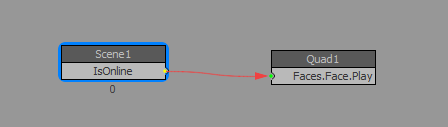

    Hi.
    In my XPression scene I have a quad with a video material assigned (Autoplay is off). The material is placed in the timeline and everything works fine.
    If I make the Quads Material public and change the videofile in Sequence mode, it does not work anymore. The video just won't play. Ist there something i missed?
    Best regards
    Bernhard Aschenwald
    Servus TV
    Red Bull Media House
    Austria
  • 2.  RE: Controlling dynamic Video Materials
    Posted 11-19-2025 09:51
    I assume the video is not a material within the project and its a file you are selecting from a folder?
  • 3.  RE: Controlling dynamic Video Materials
    Posted 11-19-2025 10:59
    Hi Simon.
    Yes, thats the case. I have one default video within the project and I want to change this by selecting a video from a folder in sequence mode.
    Bernhard Aschenwald
    Servus TV
    Austria
  • 4.  RE: Controlling dynamic Video Materials
    Best Answer
    Posted 11-19-2025 11:05
    put this is visual logic
