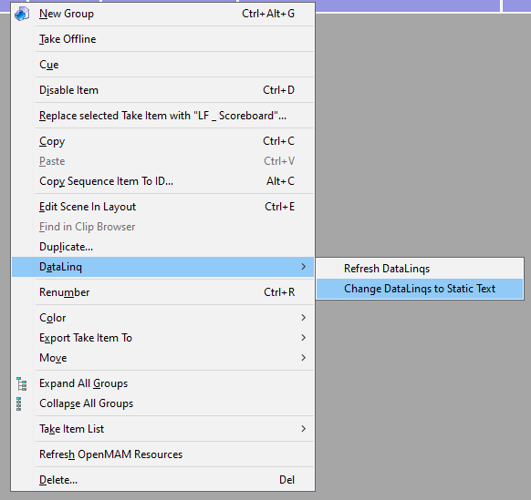

You can always disconnect the data in sequencer for that item so it doesn't change.
If that's not what you want I'd recommend setting up some kind of copy on keypress, so when ou do a keypress it copies from the datalinq fields to a static text box and they are visible while the datalinq'd text is not.

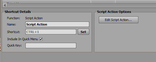

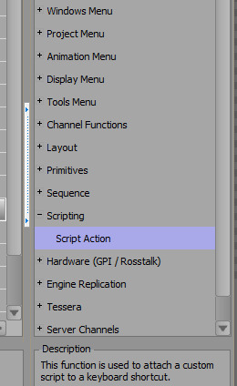

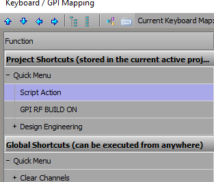

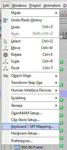

You don't need to make it a global you just need to add it to a key press.
Drag script into your shortcuts.
type your script.
Set shortcut.
Don't forget you'll need to tell the script how to find the scene first.
