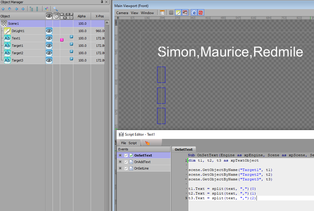

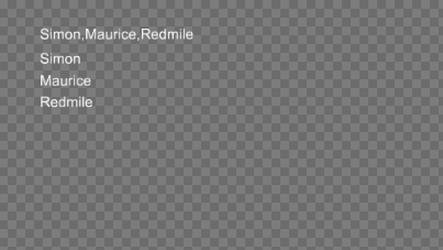

      |   view attached
    Probably something like this placed on set text will do what you want.
    dim t1, t2, t3 as xpTextObject
    scene.GetObjectByName("Target1", t1)
    scene.GetObjectByName("Target2", t2)
    scene.GetObjectByName("Target3", t3)
    t1.Text = split(text, ",")(0)
    t2.Text = split(text, ",")(1)
    t3.Text = split(text, ",")(2)
    I attached an .xpf as well.
    **Edit: (you don't need the integer value I placed in there, that was some other thinking I went down first but it has given me an idea).

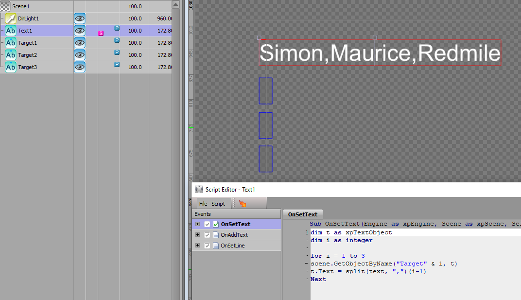

      |   view attached
    I turned it into a loop instead which makes it much tidier.
    Attachment(s)
    xpf
    SplitTextLoop.xpf   25 KB 1 version
