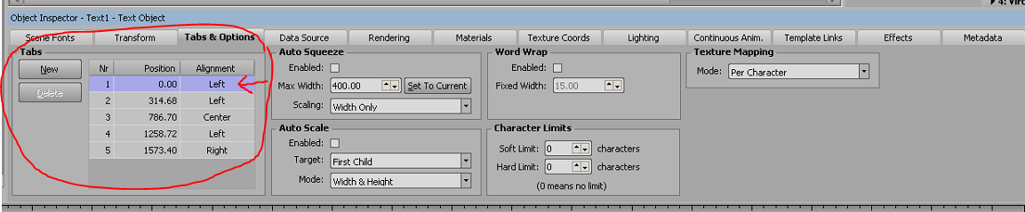

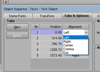

    You can simply change the text alignment, by default it will be left aligned.
    Select the text object, then go to Tabs & Options, then in the Tabs section at the top in the Alignment column it will say Left. Click on that to change it to Center.
