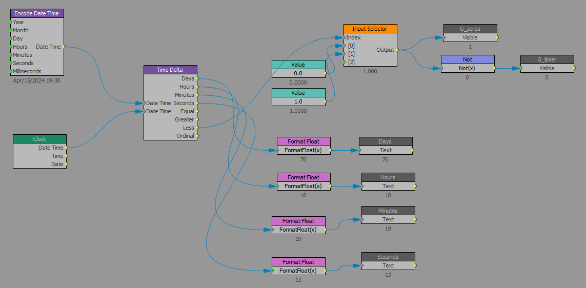

perfect example.
Sent: 07-01-2024 13:53
From: Azathoth Son of Cthulhu
Subject: Countdown counts back up when target time is reached.
So, we have an offshoot from 'less' in 'Time Delta' that goes to an 'input selector' that turns the running numbers invisible and turns place holder 'zeros' on.
You might have to change the order of your clock and encoded date going into 'time delta'
Azathoth

Sent: 07-01-2024 13:34
From: Robbie Stevens

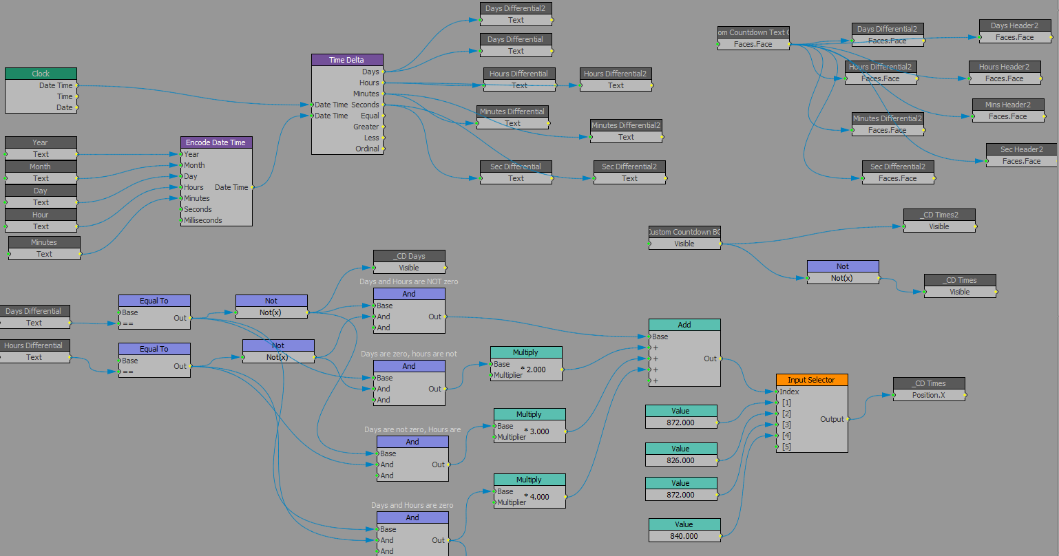

What version of XPression?
Can you post a screenshot of the Visual Logic?
Azathoth
Son of Cthulhu
Sent: 07-01-2024 12:27
When my XP scene countdown clock reaches the target time, it stays on zero for a second and then counts back up. I am using the visual logic countdown blocks.
