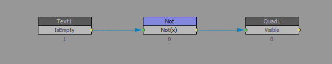

    I'm doing a crawl in xpression and i got it to work, but my blue graphics and logo won't come out on the screen. I have attached pictures.
    I have a my text link to an exel spreedsheet. Any suggestions? Also, how do i get the logo to NOT come out in between the crawl when there is nothing on the crawl?

    Use visual logic on the visibility of the logo.

    Red.... The visual Logic worked GREAT! Thank you.
