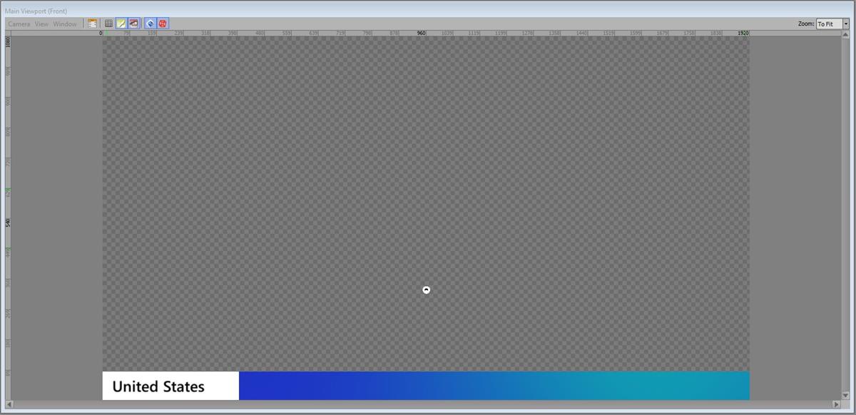

    Having two issues in designing a nice crawl.
    I have to design a crawl to handle over 1,000 names on a spreadsheet.
    The scene group looks like this:  The blue bar is a bg, the white chip with country is on a high Z-Axis.  Then I have 10 scenes parented to the group to assure I have a full screen of names before looping back.
    The first problem I am having is these names have countries associated with them.  Is there an easy way to trigger a transition so that after the first set of names for that country go by, and the next names come in, the country updates to the correct country?  SInce this is on a group, I can't really do X-ition logic nor can I use a datalink %relid% macro.  Guessing this would have to be some kind of  script.
    The second Issue I am having is when the last set of names go by, I want intentional spacing at the end...but I get text  that flashes in the empty space...as if the text field is trying to update to the empty data, but it is flashing.  Thoughts?
    Appreciate any kind of insign on this if possible.
    Adam
