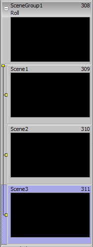

    So this is talking about masks but it shows how you use a SceneGroup which I was calling Parent Scenes (apologies that's how I think of them in my head).
    Its focused on Masks but it shows the idea that you have a SceneGroup and then scenes within it.

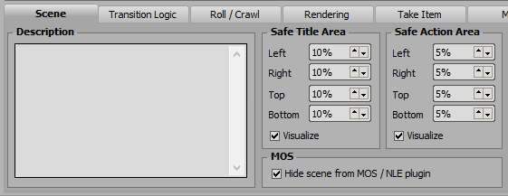

    You can put any number of scenes within the SceneGroup.
    You can hide the child scenes from MOS / Remote Sequencer using this check box
    This way only the parent scene will show up when browsing templates in MOS, NLE or remote squencer.
