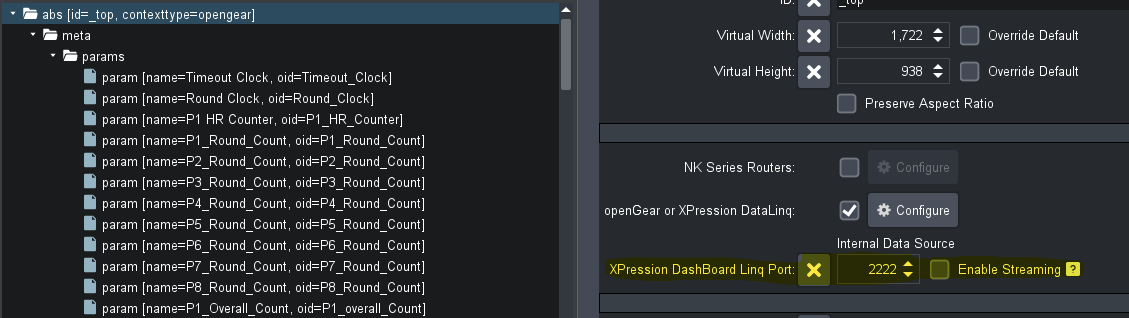

    Open up the base Abs of the dashboard panel (You can open up any element, then use the slider on the left hand pane to go all the way to the top and see abs). From there, you should see the option for XPression Dashboard Linq Port, and more importantly, an "Enable Streaming" checkbox. Make sure that's checked, and then make sure that's the only panel open streaming on that port. (Or change the port on both the dashboard and the datalinq if you need more than one on the same computer)

    Thanks Zach, I new it was a little button somewhere.  That worked perfectly!!
