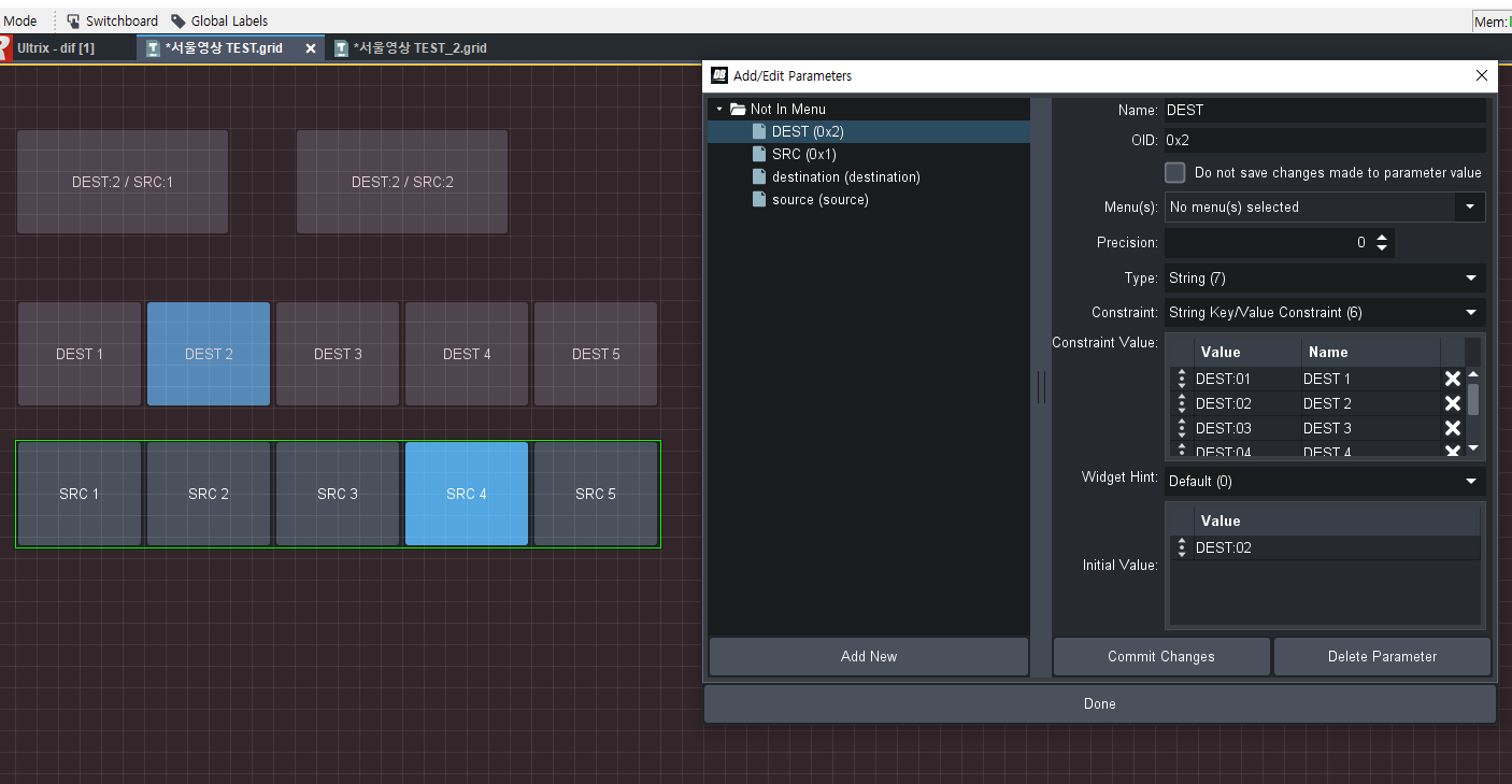

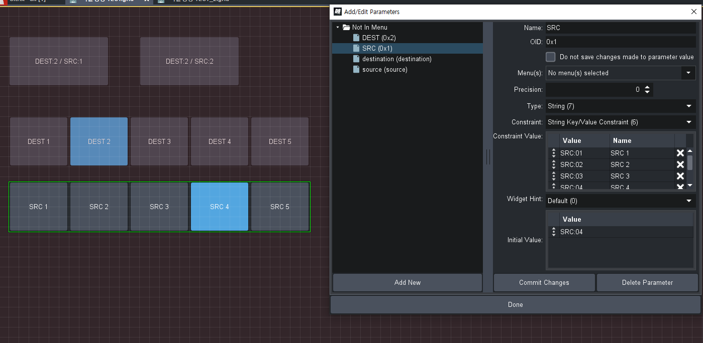

    Hey guys,
    I'm making Ultrix crosspoints on a dashboard custom panel.
    But it doesn't work the way I want it to, so I can't proceed any further.
    Attach an image.
    Can anyone confirm if what I made is wrong?

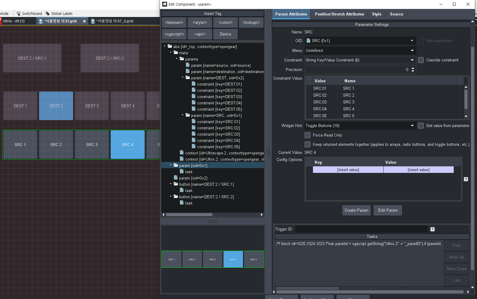

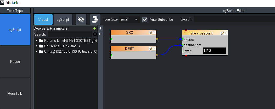

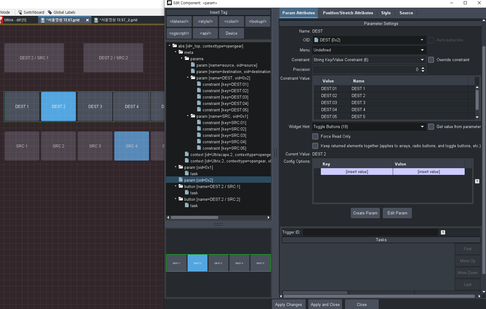

    Hi Min,
    Are you ok to share your custom Dashboard panel for me to take a closer look at what has been done?
    Aaron
  • 3.  RE: Custom DashBoard Questions
    Posted 10-30-2022 22:13
    I am attaching a custom panel of the image I uploaded.
    https://drive.google.com/file/d/1RWtC3ffsK53AsZpCoED5olKSxopqjTgb/view?usp=sharing
