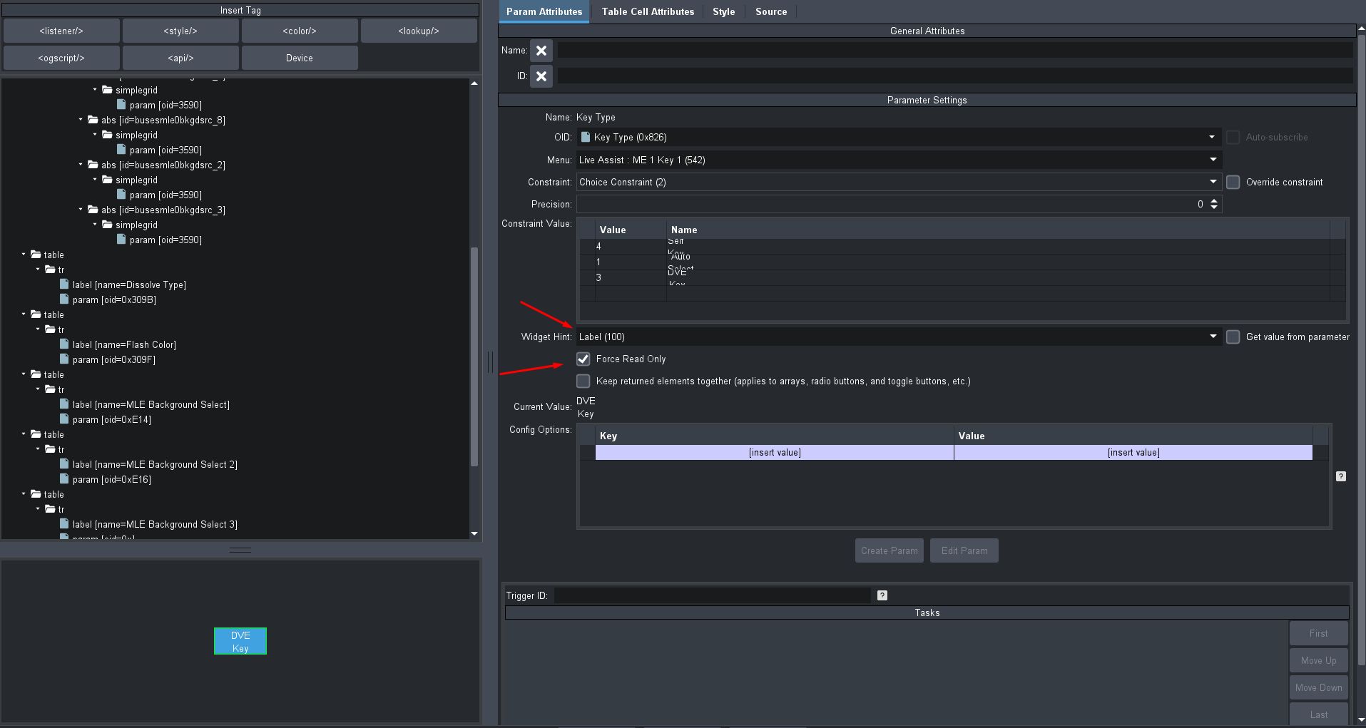

    you won't be able to make it look exactly like a button (well I guess you could put an image behind it..)
    Change the widget hint to a Label.
    Then you can Apply Changes to see it change.

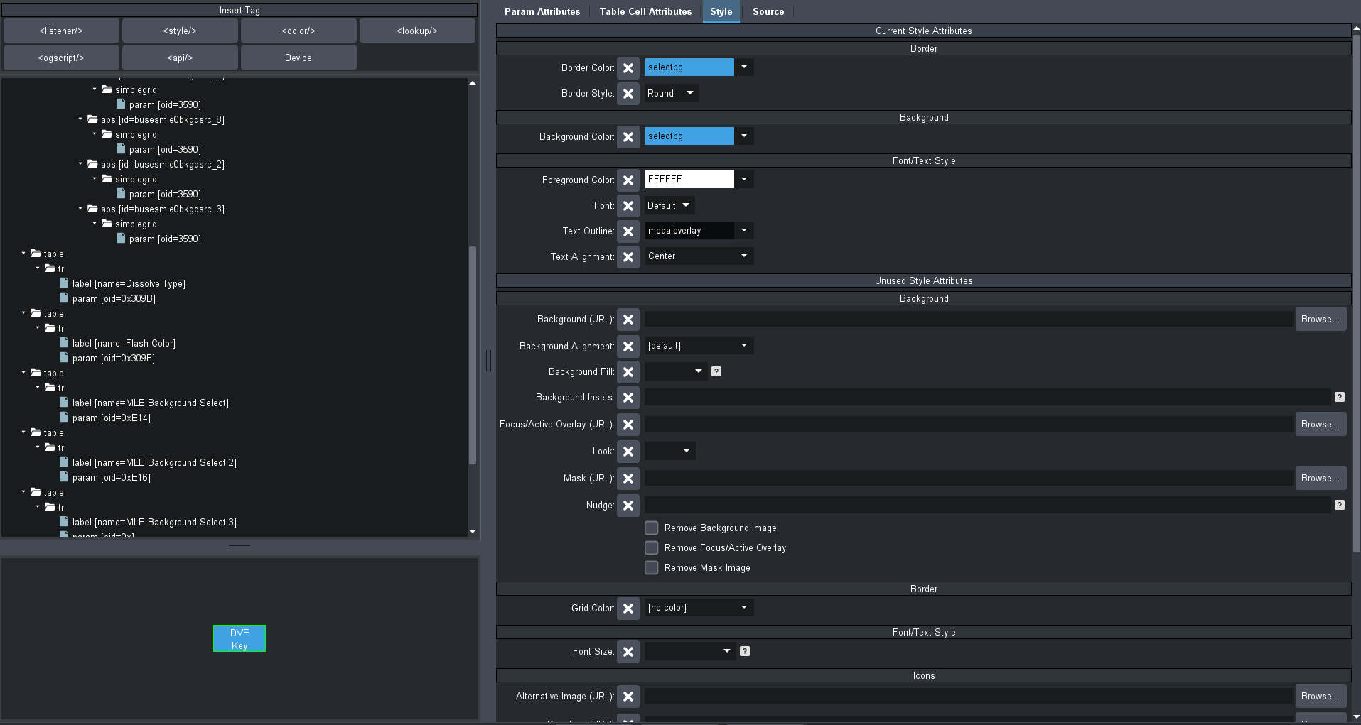

    now go to Style tab and you can manipulate the label to get it pretty close to what a "button" looks like.
    Note -- that the Style Items used all move to the top..  So you will first find them towards the bottom in their groups and then as you use them and apply changes you will see them move to the top "current" section int the sub sections...
    In a way it makes sense but it does mean for say Border or Font you could still have some adjustable items separated to two sections.

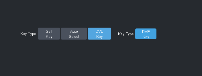

    Now when done should look like this:
    The left side was left unchanged (also let me change the keytype to show changes updating).
