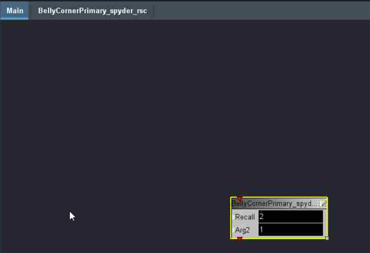

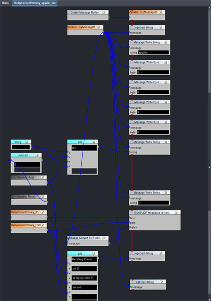

    and below is a couple of screenshots making up the visual logic function. Note that this is built only as a local function for now for ease of troubleshooting, and I would convert it to a custom Device once I got it working. The second screenshot is what the final visual logic block looks like.
    non-working visual logic-based custom function for controlling a Christie Spyder over UDP.
    I've tried this just about every way I can think of, but I must still be doing something wrong. When I try feeding the Create Message Builder block into the message of every receiving block, I get an error. I think usually the main issue has something to do with my Message Convert to ByteArray block, as when I delete that, the task works, but of course doesn't transmit to the Spyder. I've also tried sending the message through a Send UDP Messages (string) block, which makes the function work, but does not actually control the Spyder, either.
