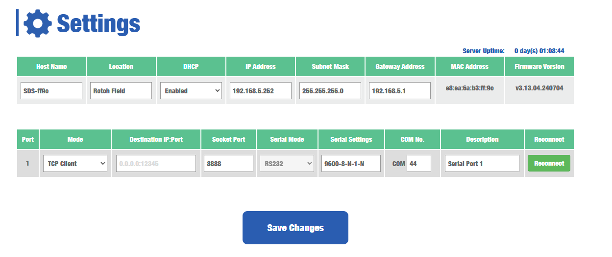

It looks like that is the local port for the connection and does not matter to the DataLinq Server. The Destination IP:Port should be the IP of the DataLinq Server and the port configured in the Data Source.

The converter should be set to TCP Client. I would need to see the adapter configuration page before i can comment on the socket port..

for the adaptor, it asks me for destination IP:port and the next is socket port. Where would I find that info for my datalinq

nothing yet. on the adapter side, should I be set to TCP client or TCP server? if I am the client would my destination be the ip of my xpression server:whichever port I designate in datalinq?

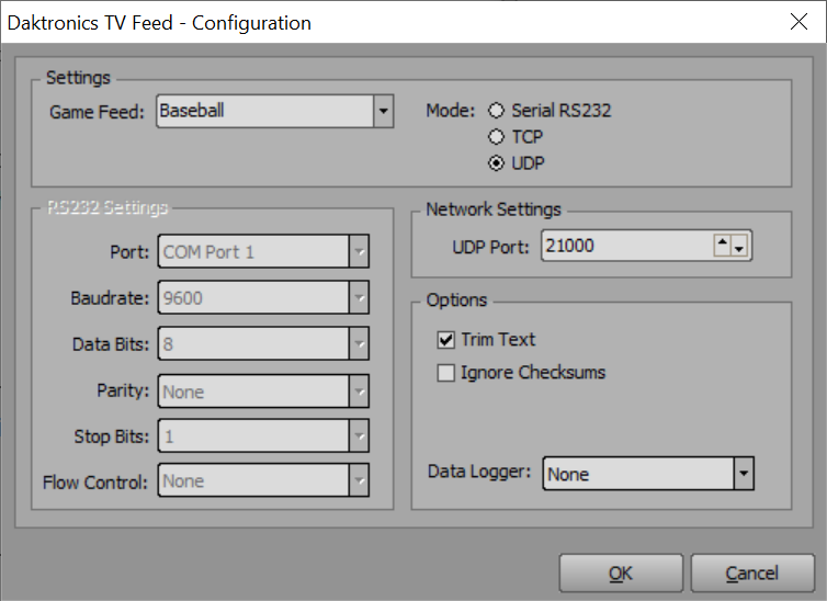

I have been trying to connect via TCP and UDP and have not been getting a result. On the allsport CG the serial cable is plugged into the data port. That goes to teh Serial to IP converter and when I am on the converters interface I try to set it up to TCP or UDP but do not see the data come through when I try to set up a datalinq server with that same port

Both UDP and TCP are supported data types for the Daktronics Source in the DataLinq Server. During configuration, you can specify whether you are working with Serial, UDP or TCP.
