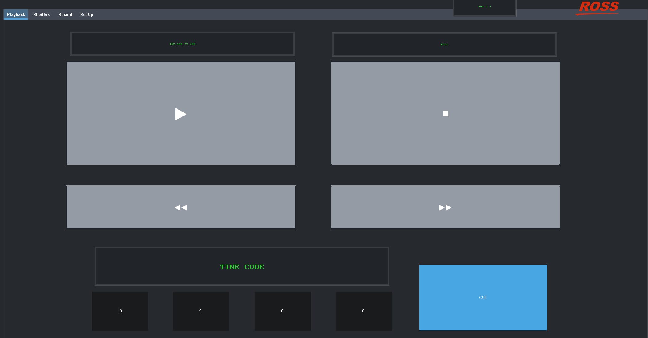

    Hello to all,
    Is it possible or does anyone have a programming example to control an old Sony VTR via RS 422 to IP converter and the dashboard and also read out the time code?
    I have found an API from Dahboerd that call VTR 422 and it works, i can control the VTR.
    I can control the VTR by entering the time code data, but I would also like to have feedback on the current position of the tape.
    Is there any template
    THX

  • 3.  RE: Dashboard and Timecode
    Posted 07-28-2022 03:39
    Here is a DashBoard Grid File.
    It will convert RossTalk Messages into BetaCam. You will need though a IP to Serial Converter.
    https://www.dropbox.com/sh/fmr60a9hx0jim1t/AABTYKoEo_asnWrc_O4NrKpLa?dl=0
