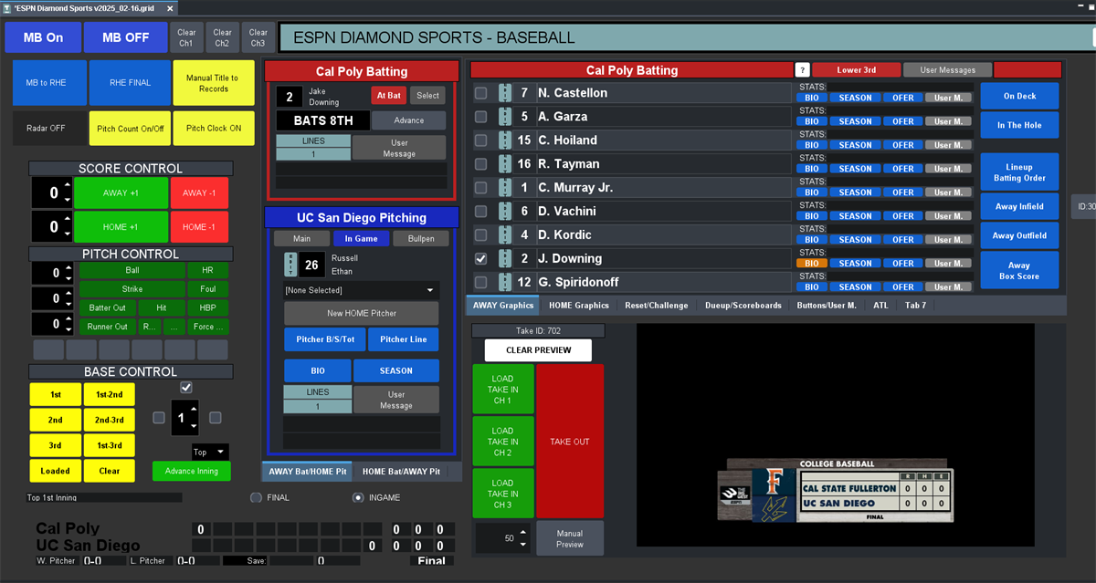

    Today I tried fixing a Desktop Preview in our Dashboard file for our player bios below.
    I watched a video on the Xpression University site and noticed that we were missing a Desktop Preview client in our Hardware setup so I added one. I was able to see my xpression previews but now every bio/season stat/and Ofer button that i trigger on dashboard gets set to Framebuffer 4 when before it would preview and load into the channel I select. Any way I can change it back?

    Sounds like you maybe have your Up Next Preview Output set to the same output as a Framebuffer. Under Hardware Setup --> Preview and Monitor tab.
