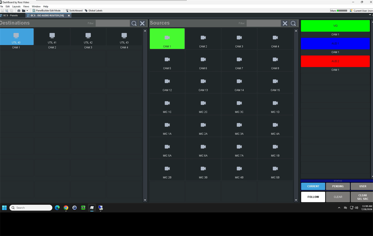

    Attaching a screenshot of my current push button router panel I setup in Dashboard.  Curious on how I change the icons for sources and destinations?

    Hi Robert, Ultrix/Ultricore platform does not support icon/image customization.
